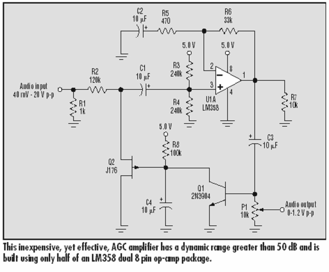

I hv the following circuit assembled. I hv used 2N 5019 fet as per the instruction of the designer. I tried with replacement of LM 358 with njr4558 ic to reduce distortion.
I hv tested the circuit by connecting satellite receiver audio out as input & tv audio in connected to the output of the circuit mentioned.
The sound is distorted after connecting the unit.
waiting for suggestions of the fellow members.

Is your 2n5019 has linear resistance to Vds characteristics.
It seem that 2n3904 create some distortion.
You need one more amplifier (same input at pin 3) to isolate the output from 2N3904.
4580 is better option for low noise low distortion wideband but higher power needed than LM 358.

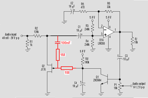

The FET is a very non-linear voltage controlled resistor. Its linearity can be made much more symmetrical if half the drain signal is fed to the gate as in my modification to your circuit.
The FET will cause additional distortion if the signal at its drain exceeds about 100mv peak. Add a fixed attenuator to the input of the circuit so that the signal is not as high.

This is the description of the project from the author:
Using the circuit presented here, you can construct a very inexpensive AGC amplifier with the following features: a dynamic range greater than 50 dB; negligible distortion to the output waveform; fast attack and slow decay; an adjustable output level from 0 to 1.2 V p-p; operation from a single 5-V supply; less than 1-mA current drain; and low cost (uses one half of a dual 8-pin op-amp package at less than $2.50 in parts). Better yet, if you need a second channel, the remaining half of the op amp can be used for that circuit.
Referring to the diagram, Q2 (a Pchannel JFET), coupled with R2 and the equivalent resistance of R3 and R4, form a voltage divider to the input signal source. With input levels below 40 mV p-p, the input is evenly divided between R2 (120k) and R3 ¦ ¦ R4 (120k). The output amplitude of U1A isn’t large enough to turn on Q2, which acts as a positive peak detector. The gate of the JFET is pulled to +5 V, pinching its channel off and creating a very high resistance from drain to source. This essentially removes it from the circuit.
At input levels above 40 mV p-p, Q1 is turned on at the positive peaks of the output of U1A, lowering the JFETs gate to source voltage. The channel resistance decreases and attenuates the input signal to maintain the output of U1A at approximately 1.2 V p-p.
The circuit, as shown, was tested with a sine-wave input ranging from 300 Hz to 30 kHz at 40 mV to 20 V p-p, a 54-dB range. It maintained the output level at 1.2 V p-p, ±0.5 dB, with no visible distortion when comparing it with the input waveform. With a 40 mV to 20 V p-p input signal, the amplitude of the signal across the JFET (VDS) measured less than 20 mV p-p.
Other JFETs with VGS(OFF) of 5V or under, such as the 2N5019 or 2N5116, should work equally well in this circuit, although they haven’t been tried. To use JFETs with higher VGS(OFF), such as the 2N3993 (it was tried and worked equally well), increase the supply voltage to 12 V.

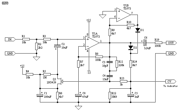

Here is a good Peak Limiter circuit that cuts the level down to its setting.
It has a full-wave rectifier and its attack time is very fast.

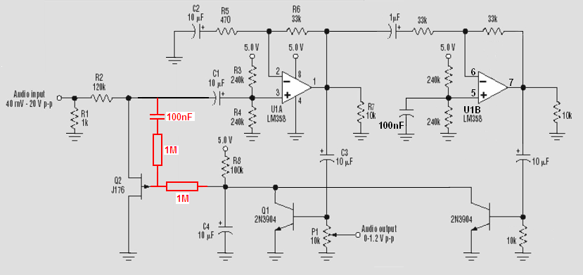

Here's a mod of the original circuit which should respond to positive and negative peaks. I have not tested it, so it's worth what you pay for it.
Audioguru's circuit is probably better (I'm no audio guru).

The "better" circuit I posted is not mine, it is from Rod Elliot. It has parts added to speed up the attack time of the FET.

The original circuit uses an old low power LM358 opamp that is horrible for audio because it produces crossover distortion and has trouble with sounds higher than only 2kHz (audio goes to 20kHz). The circuit also has a very simple Jfet circuit that produces distortion.
In post #9 I provided a link to a much better circuit that uses a low noise low distortion wide bandwidth audio dual opamp, a full wave rectifier and a fast low distortion N-channel Jfet circuit.

One of the other key points in audioguru's most recent circuit is that the FET is biased for DC, yet provides a changing AC impedance. This is necessary for the correct operation of the FET as an AC attenuator. So what this means is that there should always be a proper DC bias for the FET regardless what the level of the AC is, and that means the bias part of the circuit has to be right too. Note the first circuit in this thread does not have that kind of bias, just a couple resistors going to the AC input. This might work if the AC input is already biased for say 1/2 Vcc, but if it is a true AC input then it wont work without considerable distortion.
So check out audioguru's most recent circuit and note that the FET has DC bias but is connected to the AC through a CAPACITOR. This kind of connection regarding the FET is a necessity.
