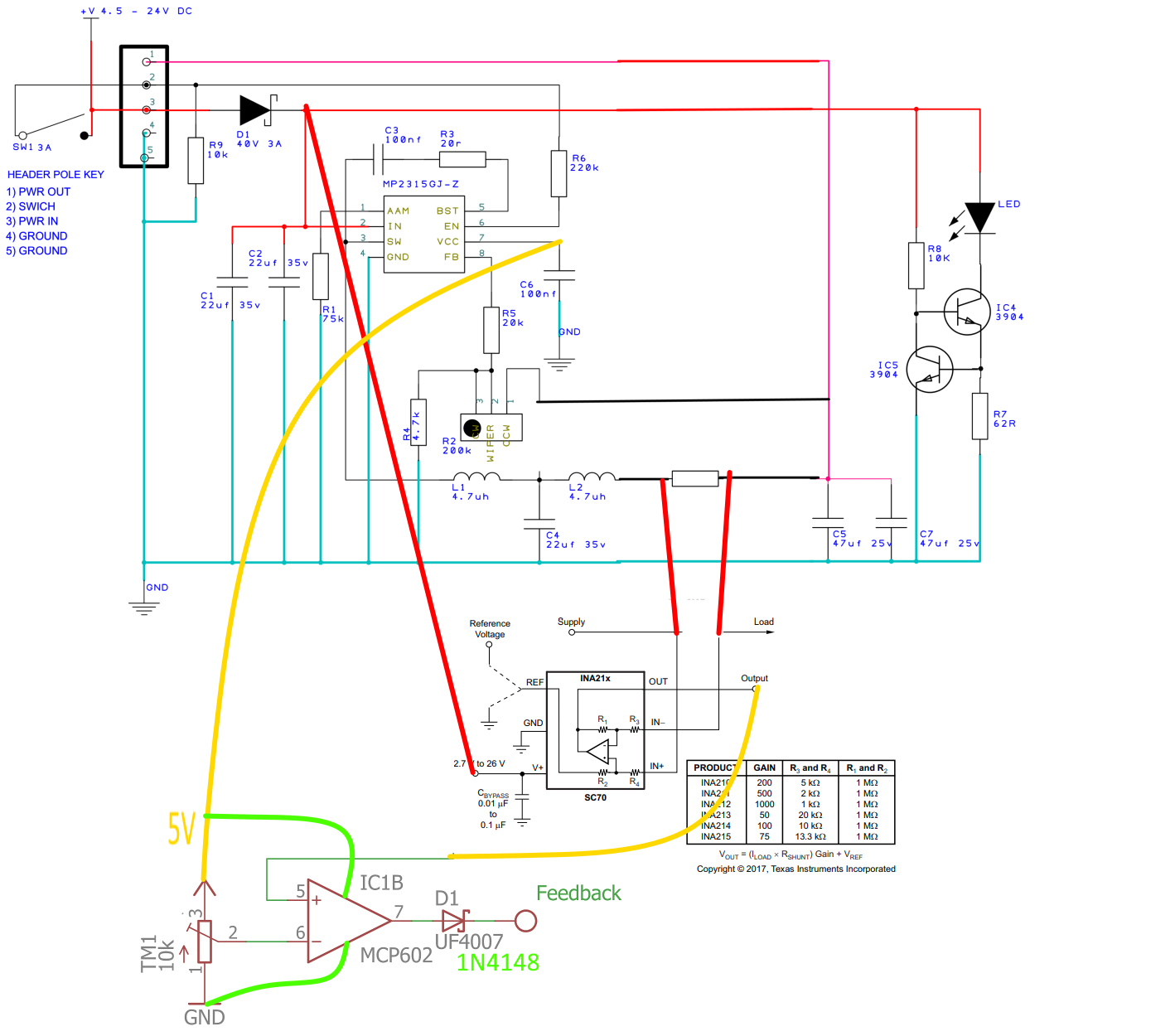

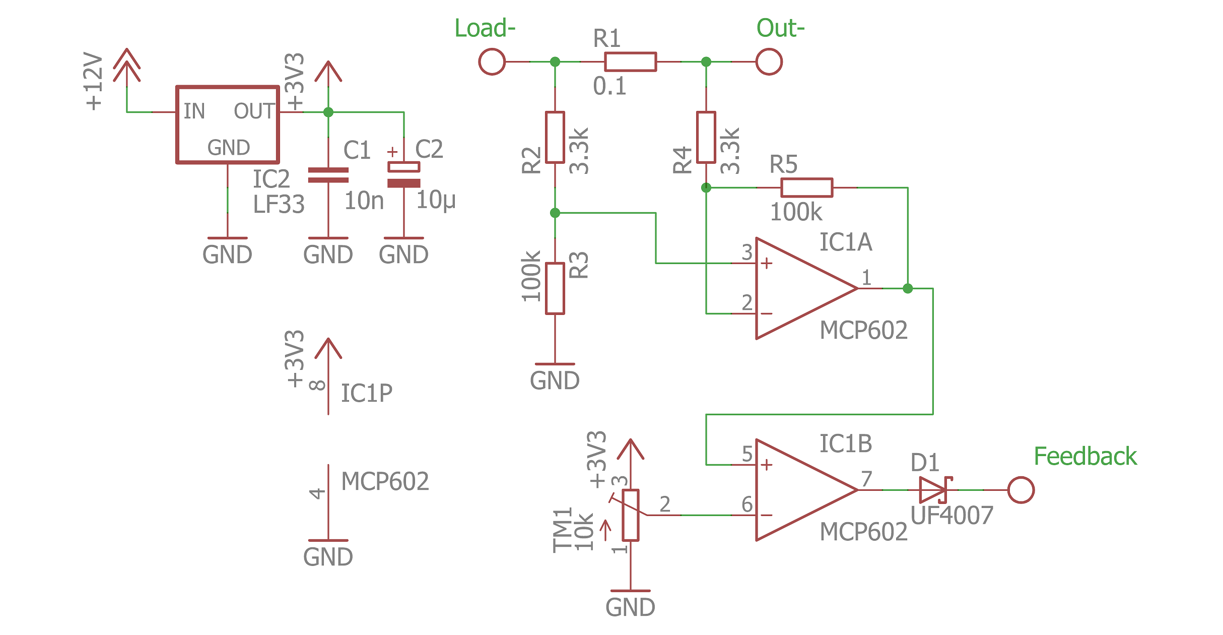

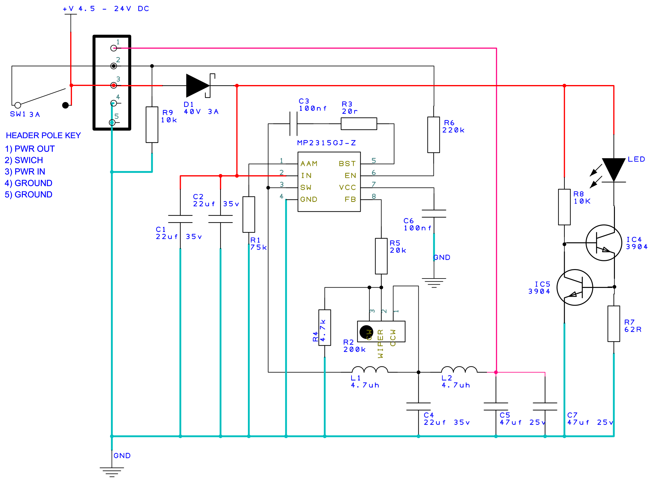

Want to add an adjustable current limit to this project of mine.
its a 4.5-24 volt input buck converter using MP2315 Regulator
I came across this article where you can implement an adjustable current limit via the feedback (pin2) of LM2587S on the buck converter.
Ive got a few questions but first is will this work with the MP2315 on my project? Tapping Pin8 of course.
Ill post the limit feature schematic below mine.
The object is to tap the feedback pin on the regulator and connect it to the cathode of uf4007. Set the desired output voltage, then adjust the 10K trimmer to lower the current. I would be adding this to the circuit as an option so it could be bypassed if desired.

The IC1A is watching the output current. What is the output voltage range? The OP-AMP can only see voltages less than it supply voltage. Probably the voltage at "Out-" is above 3.3V. There are some current sense IC that do what you want.

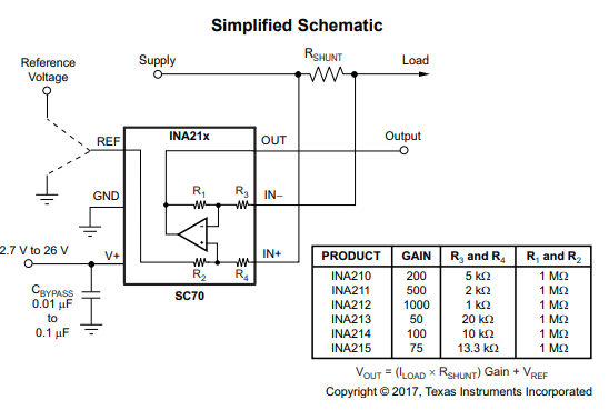

This IC and some others like it, measure the voltage across a shunt resistor and level shift it down to near ground. This one is good to 26 volts. It can measure voltages higher than its supply. Reference voltage =0V in your case.
INA214, NCS21674, NCS199.

OK i understand this. A good thing. Now let me explain what i think i understand.
INA214 has a gain of up-to 100ma. if i wanted 1A id use INA212
INA210--15 are all the same with exception of the output gain.
That gain is based on R1-4 (built into the IC)
And for my purpose Reference Voltage is ground. (don't know why)
INA210--15 need only the addition of a shunt. One like this one to complete the circuit. (and the bypass cap)

There is a voltage across the Rshunt. That voltage is moved to ground. (assuming "REF=ground)
So 1A across 0.02 ohms = 0.02 volts.
INA214 has a gain of 100. The 20mV across IN_ to IN+ now appears as 2V from GND.
This is about what you drew in post #1. The difference is that this part with only 5V on the supply can measure the voltage across the Rshunt as long as the output voltage is less than 26V. The internal resistors are very accurate! (very very!)

So if I were to use this as an adjustable current limiter and connect it to my circuit I would do the following.
I would use INA211 so i could draw up to 500ma
Screenshot 2022-05-18 at 09-32-07 INA213 datasheet Pinout application circuits Voltage Output ...png
pin 1 GND
pin 2 GND
pin 3 (PIN 2 ON MY CIRCUIT)
pin 4 to Shunt | Other side of Shunt Pin 5
pin 5 Output -
pin 6 Output +

Out max is 500mA. Rshunt=0.05 ohms (or 0.047) Voltage across Rshunt at 500mA is 0.05V
Use INA213 with a gain of 50. The output voltage will range from 0V to 2.5V with current of 0 to 500mA.

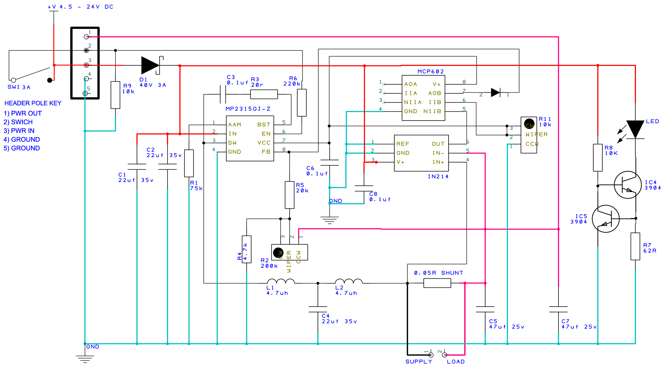

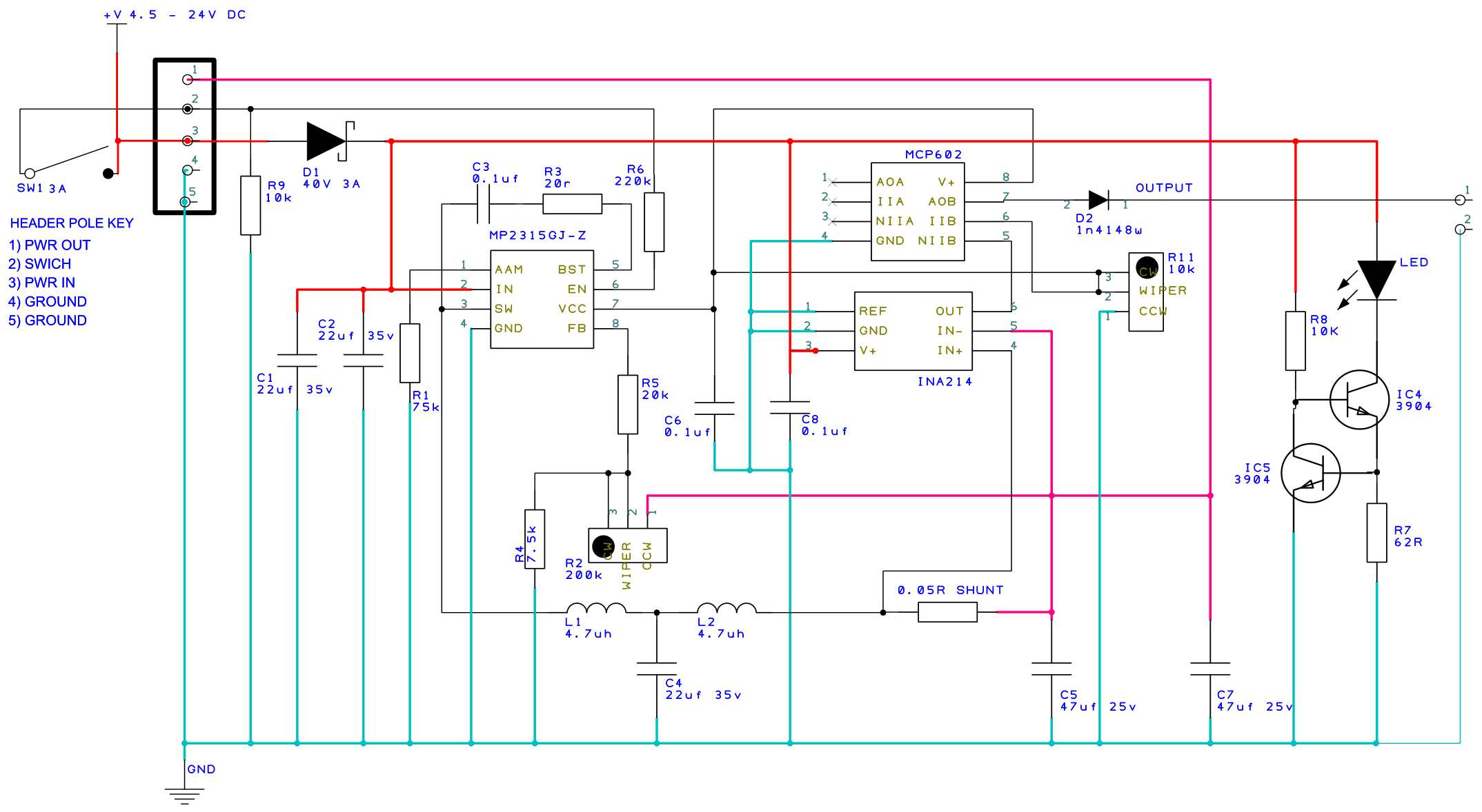

Ive implemented it into my schematic. I am assuming the diode from pin 7 of the 602 goes to the feedback pin of the MP2315. Please let me know if i got this correct.
And supply / load is where I would connect an LED (for example)

sorry for the delay. I reached out to a friend for help understanding this. He helped me understand gain and how the two IC's work together. Im still a long way off but ive revised my schematic. Please give me your opinions/feedback.
Thank you Ron.

Ill tell you what i understand...
The MCP is an OpAmp. Its function is to amplify weak signals.
The 5V from pin7 is required to power the OpAmp. It will operate as low as 2.7v.
The INA21X is a current shunt monitor. it is powered directly from the circuits power supply 4-21volts.
The suggested INA214 has a gain of just 50ma but that will be amplified 100 times (across the shunt) producing upto 500ma
The output from INA214 may be weak so its passed to the OpAmps Inverting and Non-Inverting inputs (+ & -) for amplification.
The result voltage is available on the Analog Output. In this circuit that would be channel B of this 2 channel component.
Im sure there is more to this but I want you to know that i am trying.

The INA doesn't amplify current. It's inputs read the voltage drop across the current sense resistor and amplifies it by the gain factor of 100. If there is 1A flowing thru the 0.05 ohm current sense resistor, there will be a voltage drop of 50mv, which is then amplified 100x by the INA, producing an output of 5v. Its not apparent what you intend to do with the INA output.
Im hoping that watching the associated video with the link above makes it clear what id like to make here. If i misunderstood your question i do apologize.
I was under the impression the INA output lead into the MCP then to the Analog Output. Thats what i thought you were asking.

Hi
How is the INA214 output voltage supposed to be used?
I believe there is a reluctance to help because you are attempting to design features into a system that is really beyond its intended capabilities. SMPS chips designed for current limit control capability have internal circuits that alter the behaivor of the control loop to limit current. I'm afraid someone else will have to chime in here to help...
