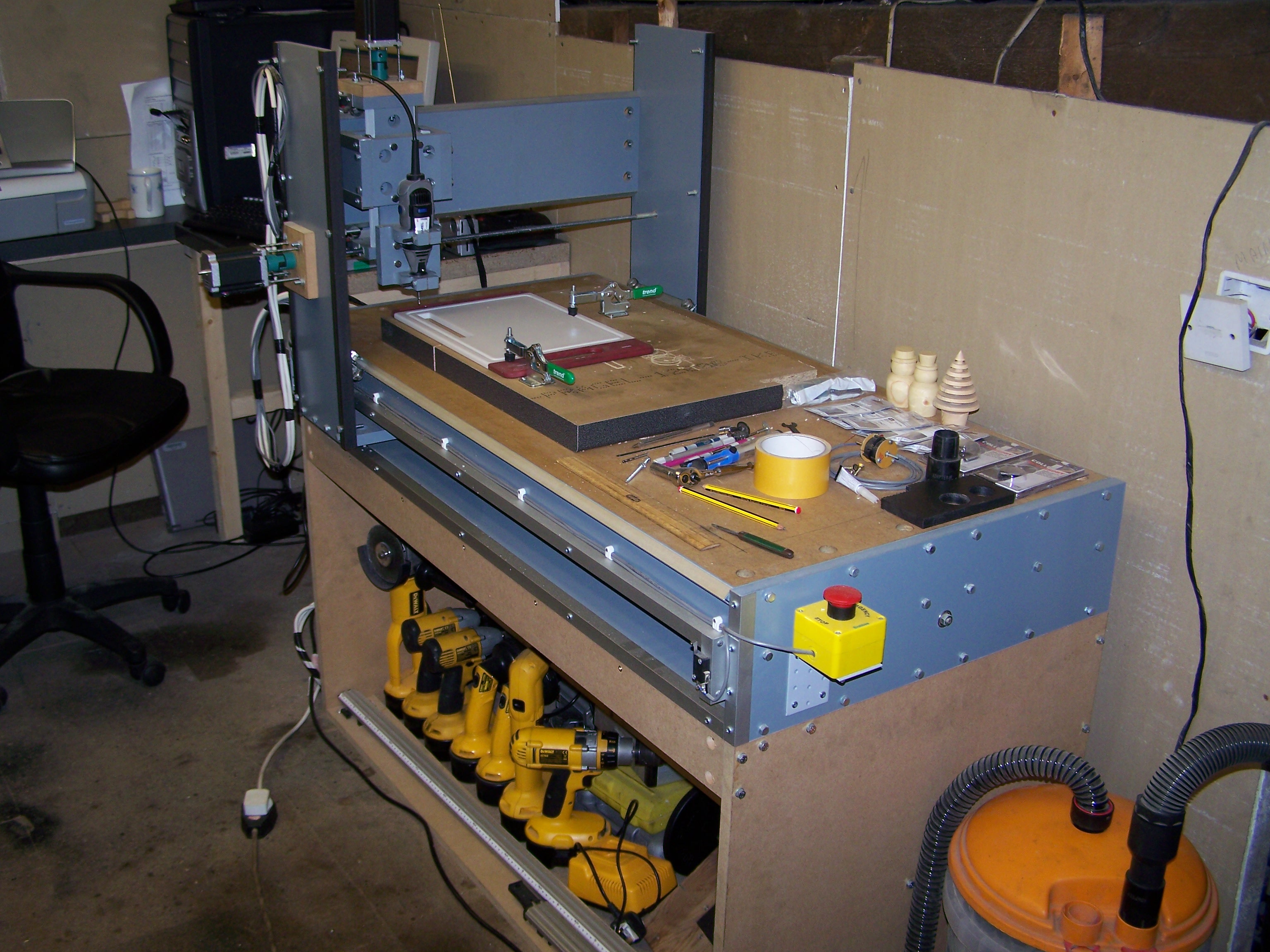

I built the very 1st version on that website, with the table at 2' X 4'.
I used NEMA23 steppers and M8 X 1.25 threaded rod for the leadscrews. It would have been much faster with proper leadscrews, but it produced decent results for the projects I cut on it (mainly wood)
Unfortunately, I had to dismantle it due to a lack of space and the weight of the thing - it was in the loft and I had concerns about the ceilings below. The machine used about 11 or 12 sheets of 2' X 4' MDF plus the weight of the fasteners and angle-iron, motors etc and when small cracks started to appear, I pulled it apart with the intention of building a smaller one. I haven't got around to doing so yet though.
Mick that CNC looks sexy heh. and the dewalt collection is awesome! i had only 1 drill and cost me about $100 heh... I dont have much space here really. I was thinking of a SMALL CNC. Something in the rage or 1.5'x1.5' almost everything i work on fits in that realm of space. If i had a CNC the first thing i think id make is a case for my pickit 2 heh.. it has taken so much damage :( heh but its still alive

Jason,
bear in mind the size of the actual cutting area. If you need to cut items up to 1.5', your machine will need to be larger to accomodate this.
