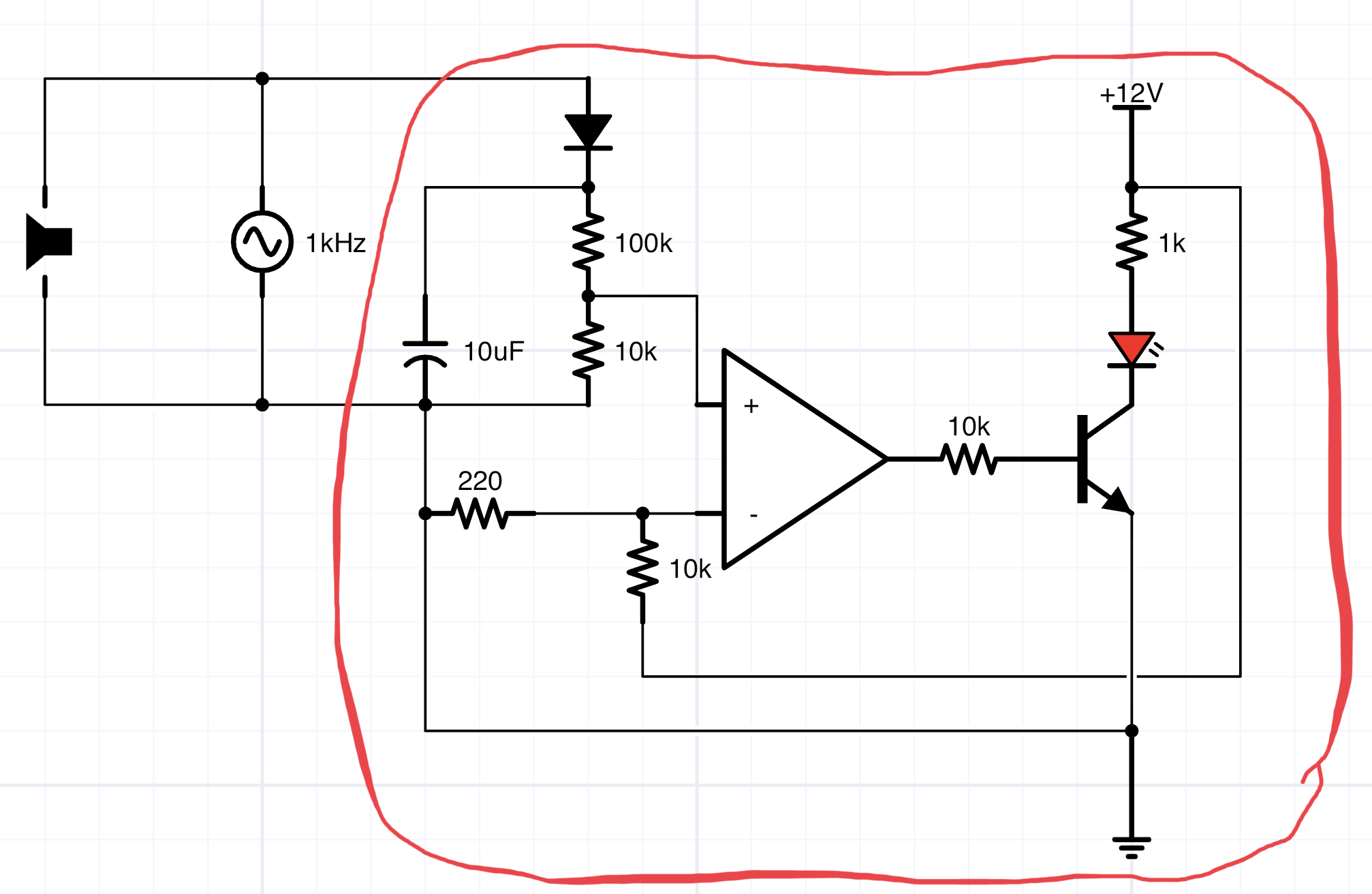

You don't need to run wires everywhere back to the source. You just need a 5 to 12v power supply (wall wart) at each speaker. I recommend 12v
The connections to the speaker just need to be connected to a sample/hold peak detector. The capacitor prevents flicker and will stay on for about 1 to 5 seconds after the speaker stops talking (it will take longer if they were really yelling and approaching the 100vac power to the speaker). The resistors, as configured, will detect even small noises by the microphone input. Make the voltage dividers less extreme to sense only loud noises at the mic.
Note, this solution requires a real 12v supply at each speaker and connect to the two speaker wires to detect the peak & light the LED.. red circled area is the new circuit for each speaker...

The peak detectot circuit in the next post will work if the opamp is rail-to-rail and is powered.
