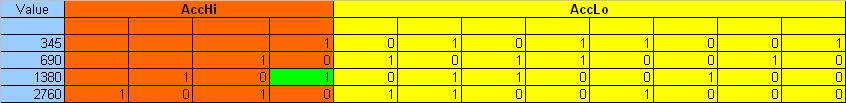

But i have a small question.
When I multiply 345 X 2 = 690
1010110010 That is correct
But when I double this 690 it will be = 1380
10101100100
Can you tell how this bit0 will be get set in the AccHi register.
An RFL instruction moves all bits left one place. The bottom bit gets the value that was in the carry flag and the top bit gets placed in the carry flag.
Can you answer your question now?
I have attached the number pattern the green cell is my problem how will it be set?

Hi mike after reading lot of times now I got understood. I got what I was expected.
What I’m doing with your routine?
I’m going to sample my AD value 8 times & going to divide by 8 to get the average.
Thank you very much mike
I just got a point. The bottom bit gets the carry bit value after the instruction completed I believe.
Ex after the RLF completed the bottom bit will get sets.
Now I understood
thanks again mike.
