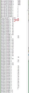

Add GPS/PARSE to 8xSERVO-MOTOR CODE in Oshonsoft
You should print with Serout only when isDone = 1.
The danger with this is that if isDone gets set then it doesn't get cleared and you're back to it continuously sending.
If code is added as shown above (#252) then it can send serial once per second.
I don't know how to clear overrun or framing errors as I've never experienced them. As the comment says, just wishful thinking. Line 283 says 'this is kinda wishful thinking
To send a string with the ISR serial send, do,
str="Whatever you want"
for i=0 to len(str)-1
    call putFifo(str(i))
next i
The output should appear on RC1 which was (mistakenly) input but is now output.
I'm not sure if the -1 is needed. I.E on len(str)-1
I think the confusion is because camerart keeps using the Oshonsoft software serial output routine instead of your ISR driven routine. He puts Serout statements to print out debug or test items to verify things are working.
Maybe take his latest "Serout" statement in his last code posting, and re-write it to output the same with your ISR serial routine, to the same port/bit. That said, the Oshonsoft Serout is just timing loops for its bit-banging, and should not have any affect on anything else that is interrupt driven. All it does is delay the main code while the bits are sent out.
He needs to determine which method, if any, affects his overall code performance, including the servos. If one affects the servos more than the other method, that gives an indication as to where to focus attention to.
The problem is because it uses CCP2 to generate the output pulses it has to be on PORTC.1. (no PPS on that chip)
I wrote the code in C (on a PIC18F2620) before converting and used an Arduino with soft serial to read the serial in and send it to the monitor.
C, do you have an arduino lying around that you could do the same with?

No RC1 output! Would you show where RC! is outputted in the CODE please?
C
Hi M,
There are 2x $ in the BUFF?
C
It seems the first if strcount=0 stores the $ and simply falls through to the next if strcount <> 0 where rec is still $. Thus it adds it twice. The first if should jump to the end of the “uart if” routine
Hi S,
I attempted to fix it, but failed.
Let's see what M comes up with.
C.

Hi S,
I gave it a quick try, which cured the 2x$, and looked like it was moving SERVOS in 'sim' No LED flash.
I'll spend more time tomorrow.
