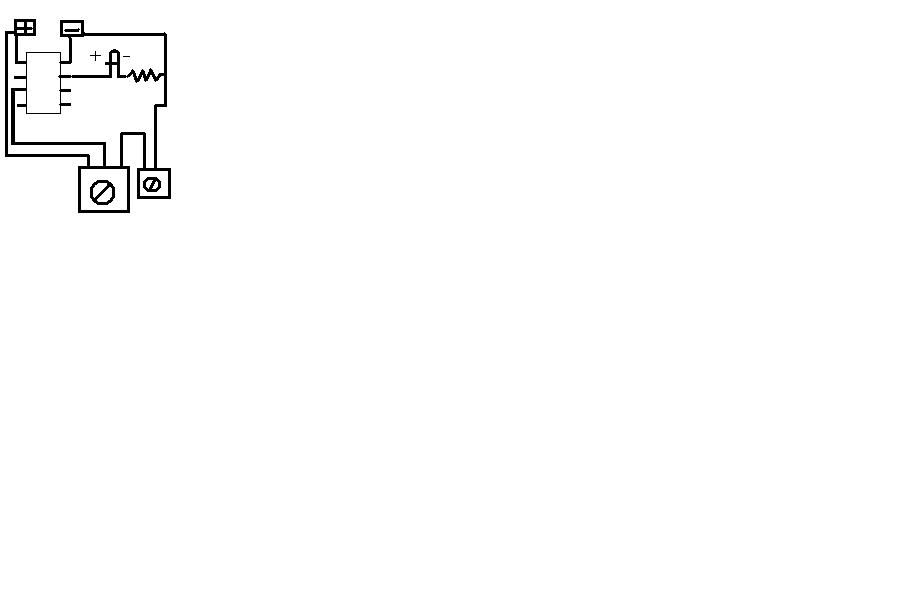

Hey trvo I just finished learning the basics of ADC using a 12f675. Here is what I learned. This program will fade an led based on the position of the pot. the big pot is to fade the light, the little pot is to trim the voltage so you have from off to full. without it you will go from full to off and the it will get bright again going in a circle. The big pot is 10k the little one is 5k. Tell me if you have any problems with it.
;fade
	list P=12f675
#include <p12f675.inc>
	__config _INTRC_OSC_NOCLKOUT & _BODEN_OFF & _WDT_OFF & _PWRTE_ON & _MCLRE_OFF & _CPD_OFF & _CP_OFF
	ERRORLEVEL -302
	cblock		20h
	timer1,timer2,timer3,slow,pwm
	endc
	bsf	STATUS,RP0		;bank 1
	movlw	0x38
	movwf	ANSEL
	movlw	0x38
	movwf	TRISIO
	bcf	STATUS,RP0
	movlw	0x07		;turn off comparitors
	movwf	CMCON
	movlw	0x0d
	movwf	ADCON0
start
	bsf		ADCON0,1
waiting
	btfsc	ADCON0,1
	goto	waiting
start1
	movlw	0x0f
	movwf	timer3
start2
	movf	ADRESH,0
	movwf	timer1
	movwf	timer2
start3
	movlw	0x01
	movwf	GPIO		;turn on
	decfsz	timer1,1
	goto	start3
pause1
	movlw	0x00
	movwf	GPIO
	incfsz	timer2,1
	goto	pause1
	decfsz	timer3,1
	goto	start2
	goto	start
	end

I read a little about your switch and it seems that it just needs the pwm to adjust the voltage. Duty cycle of 50% means half of the voltage of your power supply when run through the regulator. The two potentiometers are pretty necessary in my opinion. They are super cheap and I also don't know another way to get the system trimmed without them. Post a diagram of what you got so far.
