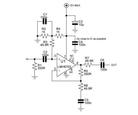

Here's the amplifier used by VK5TM (https://www.vk5tm.com/homebrew/dds/dds.php ):
I have an LHM6609 in my parts box and think it should work with appropriate modifications (voltage feedback vs. current feedback for the 6703), particularly at the lower frequencies (<10 MHz) that I intend to use.
Edit: My concern is whether that chip, which dissipates up to 480 mW at 5V and 125 MHz, needs a heatsink?
John
What kind of gain are you looking to get, and what kind of load do you intend to drive with the chip? That will dictate what power it will have to dissipate, and i guess we can assume a sine wave output (so voltage/current in the chip itself can be calculated and thus the power dissipation).
I see that 6609 chip requires at least a 6.6v power supply (like plus and minus 3.3v). I was hoping to get something that runs off of just +5v if that is possible.
I see that design is not good for low frequencies however, at least not as is. The low frequency cutoff is somewhere around 32kHz. The frequency generator chip goes down to sub Hertz values, like 0.04Hz or thereabouts. If we wanted to get down to low frequencies like 1Hz, we'd have to change the design a little.
I have a couple 800MHz chips around too but i think they require plus and minus 5 volts to operate well. I was hoping to get something that worked with a single +5v supply. Maybe we should look around a little.
It looks like the max power output with a sine wave and equal plus and minus supplies is:
Pmax=(2*Vcc^2)/(pi^2*Ro)
That's with Vout set to the worst case output voltage (that causes the maximum power to be dissipated in the chip).
So with a plus and minus 5v supply, the max chip power would be a little over 100mw with Vout set to worst case and Ro equal to 50 ohms, and that is with direct drive.
It's probably the same using a +10v power supply if the load is connected to a point at half of Vcc and the zero AC line is at half of Vcc also.
The chip max power point occurs with an output of about 3.2v peak. For peak voltages above that the chip voltage drop is less so chip power goes down, and for voltages below that the chip current is lower so the power goes down.

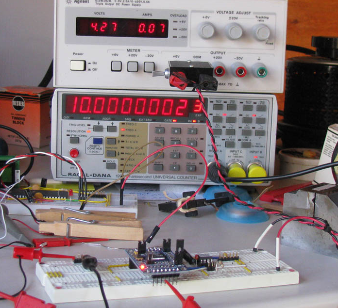

Got my AD9850 running today. Seemed that I needed to add a reset to get it started. Runs fairly stable. Only had to change the LSB by adding 0x02 to the tuning word to get the frequency close. Calculated frequency is 10.000 kHz:
Running temp with no appreciable load and reduced voltage is about 35°C (125 MHz); room temp = 20°C by IR non-contact thermometer.
EDIT: Forgot to add, P-P voltage is 1.16V for the sine wave.
John

Is that voltage measurement at the reduced voltage of 4.27 volts or at 5.00 volts?
I will be running mine at 5 volts.
Also, you might want to measure the output at various frequencies because of the filter which is of fairly high order and not completely flat.
The output voltage was fairly constant over the range of 4.95 to 4.27 as shown. I reduced the voltage just to see how much it affected the temperature rise. Effect on tuning was very slight. Yes, there seem to be two versions of the ebay board floating around. This link shows both in the second image. Mine is the bottom version (https://nr8o.dhlpilotcentral.com/?p=83).
The crystal seems to start slowly/erratically regardless of voltage, which is the bug right now that concerns me.
