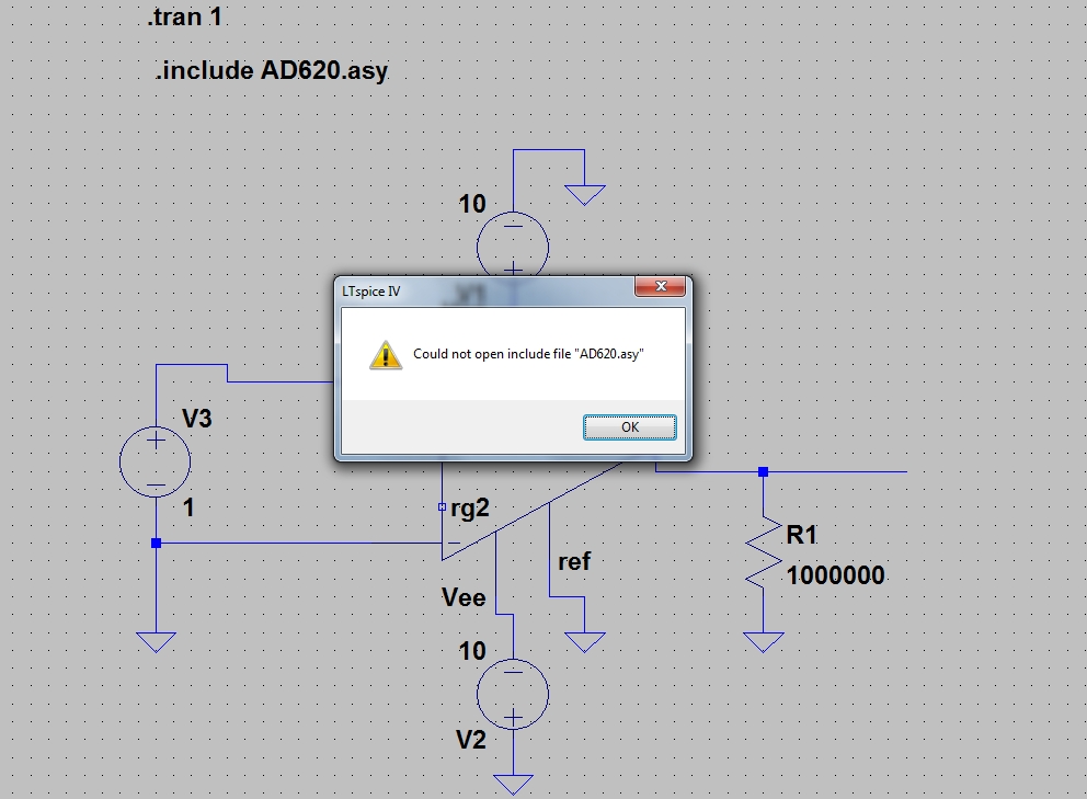

ericgibbs, please help a poor soul. I have tried a sym AD620, but I get errors like "unknown subcircuit called" in LTSpice IV.

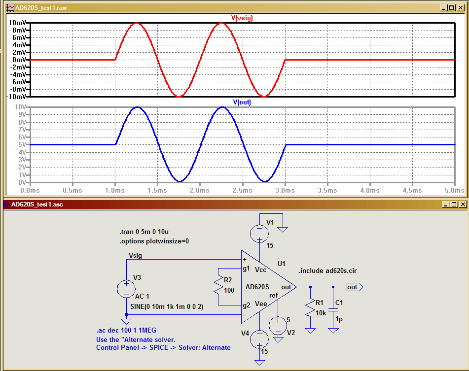

All the AD620 information is here, **broken link removed**
also attached a zip with *.cir and *.asy
If you have a problem , post your asc file.
E
BTW: you do not include AD620.asy but AD620.cir or AD620.mod
  • vizip.zip

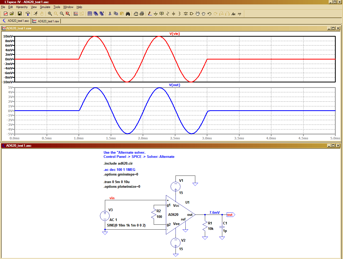

Try this asc file.
NOTE: the text information required on the circuit.

ericgibbs, to say thank you is necessary when somebody helps you and it's mandatory when the help is given at the right moment.:eek:
The ".cir" file in my case wasn't in the same directory withe the ".asc" file. I think this was the biggest problem.

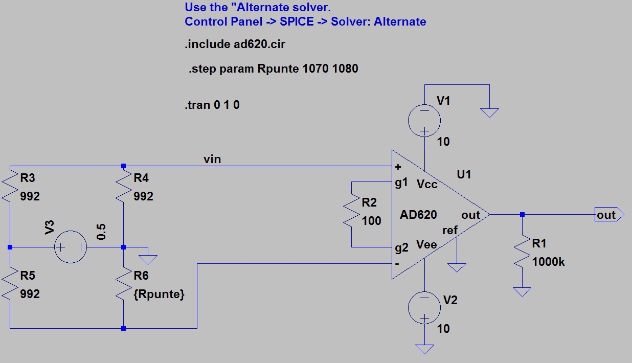

In order to help somebody else in need I have put here an archive with the files you gave me, with a little extra: a Wheatstone bridge;)
All the best!
  • AD620 Wheatstone Bridge.zip
