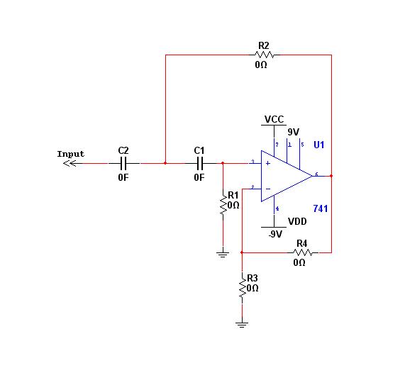

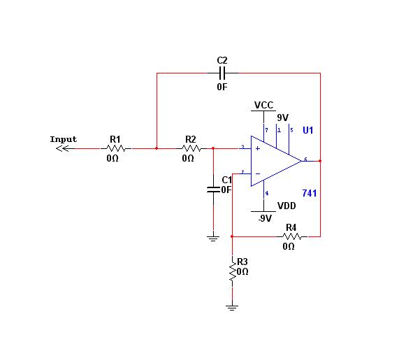

Okay, I have finished the circuit, and the calculations to go with them.
The circuits are attached, and the calculations are:
Low Pass
α = 1.414 (number of stages = 1)
k = 1
f = 1kHz
ω = 6283.2 (2 x pi x f)
C1 = ≤ 5nF (1nF)
C2 = 10nF
R1 = 15.9k (15k)
R2 = 169k (150k)
R3 = 0
R4 = 0
Low Pass 2
α = 1.414
k = 2
f = 1kHz
ω = 6283.2
C1 ≤ 15nF (10nF)
C2 = 10nF
R1 = 10k
R2 = 27k
R3 = 75k
R4 = 75k
High Pass
α = 1.414
k = 1
f = 1kHz
ω = 6283.2
C1, C2 = 10nF
R1 = 22k
R2 = 11.5k (10k)
R3 = 0
R4 = 0
But from what crutschow said, then the f should actually be the drop off rate of the filter, which would explain why my filters are doing such a poor job of "filtering".
Circuit 1 is the low pass, and circuit 2 is the high pass.
Thanks for your help.
Vince

f is the point at which the filter has rolled off -3dB (the corner frequency).
The drop off rate (in dB/octave or dB/decade of frequency change) is determined by the order of the filter. The second-order filter you have designed would have a drop off rate of 12dB/octave or 40dB/decade.
R3 and R4 are equal to infinity (no resistor) not 0 (a short).

A Sallen and Key second order Butterworth filter can have a gain of 1 and the resistors or capacitors have one simply double value of the other.
Or, the resistors can be the same and the capacitors can be the same and a Butterworth response is when the opamp has a gain of about 1.6.
