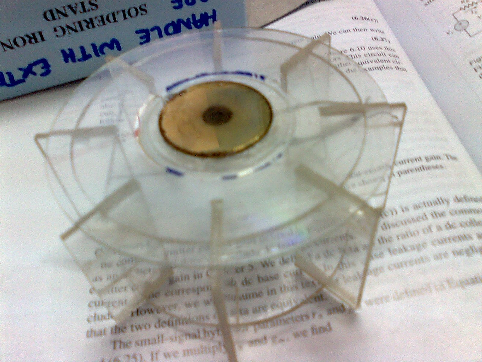

Hello guys, I'm building a disdrometer for my weather station project. I'm currently using a piezo speaker from an old radio mounted on a cd (small type) disc to increase it's sensitivity. When rain hits the surface, the transducer gives some output.
I got no pictures yet, but I'll post it later.
I've checked the output from a scope, and to put simply: If I tap gently on the cd platter, the output goes to around 100mV in a flash, and for a stronger one (that I render would be equivalent to a large raindrop) is around 2V.
Question:
1. I don't know if the scope is not good, but is the output too big for a small piezo transducer? It's just around 4.5 cm in diameter.
2. I'm planning to use an LM386 to amplify the readings up to 5V max (to be fed into a PIC18F) so before I do that is that okay? Or are there better parts to use?

A very large raindrop or hail will cause the output voltage of the piezo transducer to be so high that it damages the input of the amplifier.
Look at an Electronic Drums circuit that uses a zener diode to clamp the piezo transducer's output voltage to a reasonable level.

Here's my disdrometer:
https://www.electro-tech-online.com/attachments/disdrometer-jpg.34688/
Now I'm wondering: The output observed from the scope is bipolar,but the reference for the LM358 is gonna be 5V to GND, which means I can't see anything under the 0V region. Is there a way so that the negative output can be included into the positive signal output?
And...thanks for the schematic. How does the zener really function anyway?
