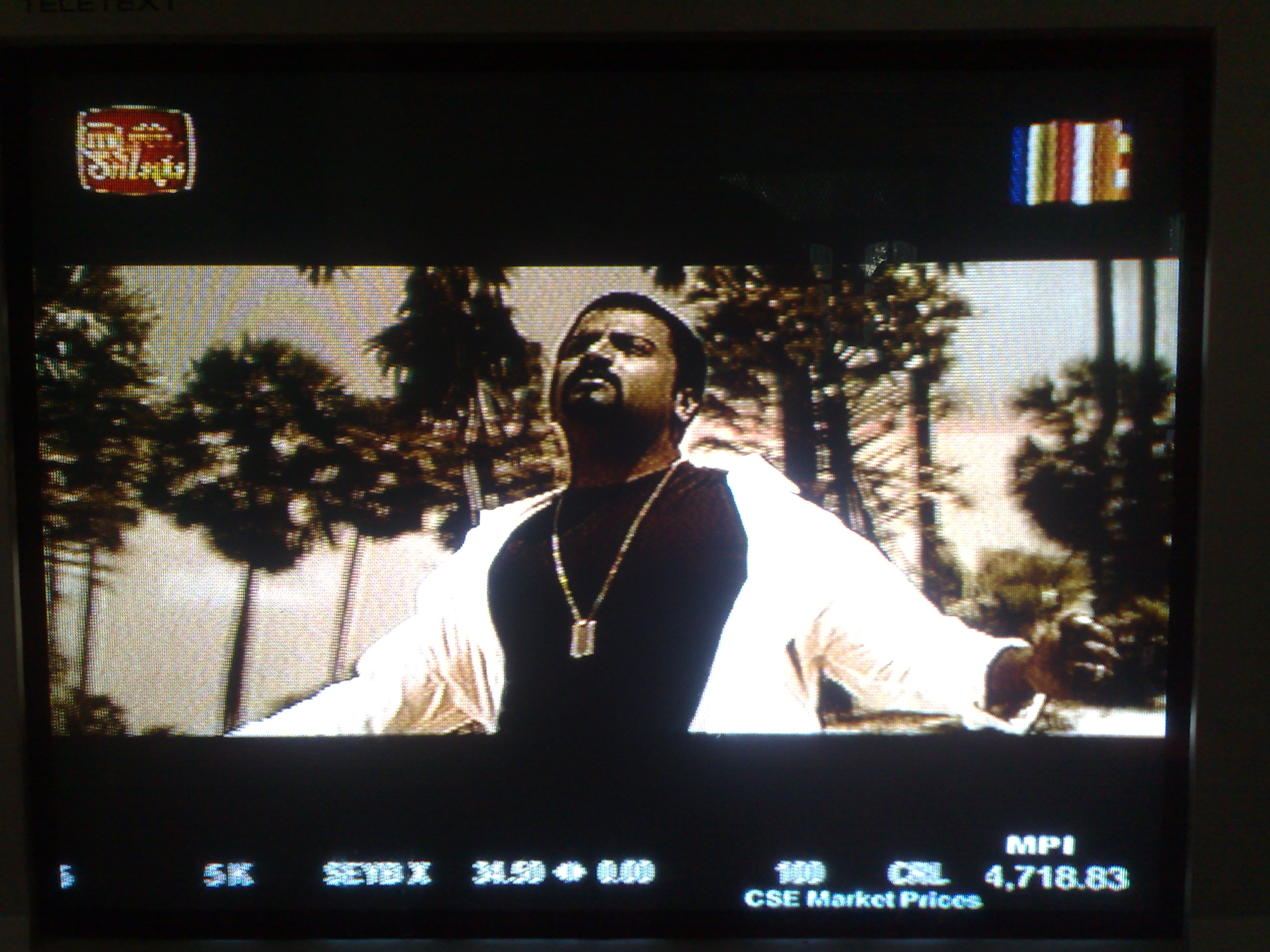

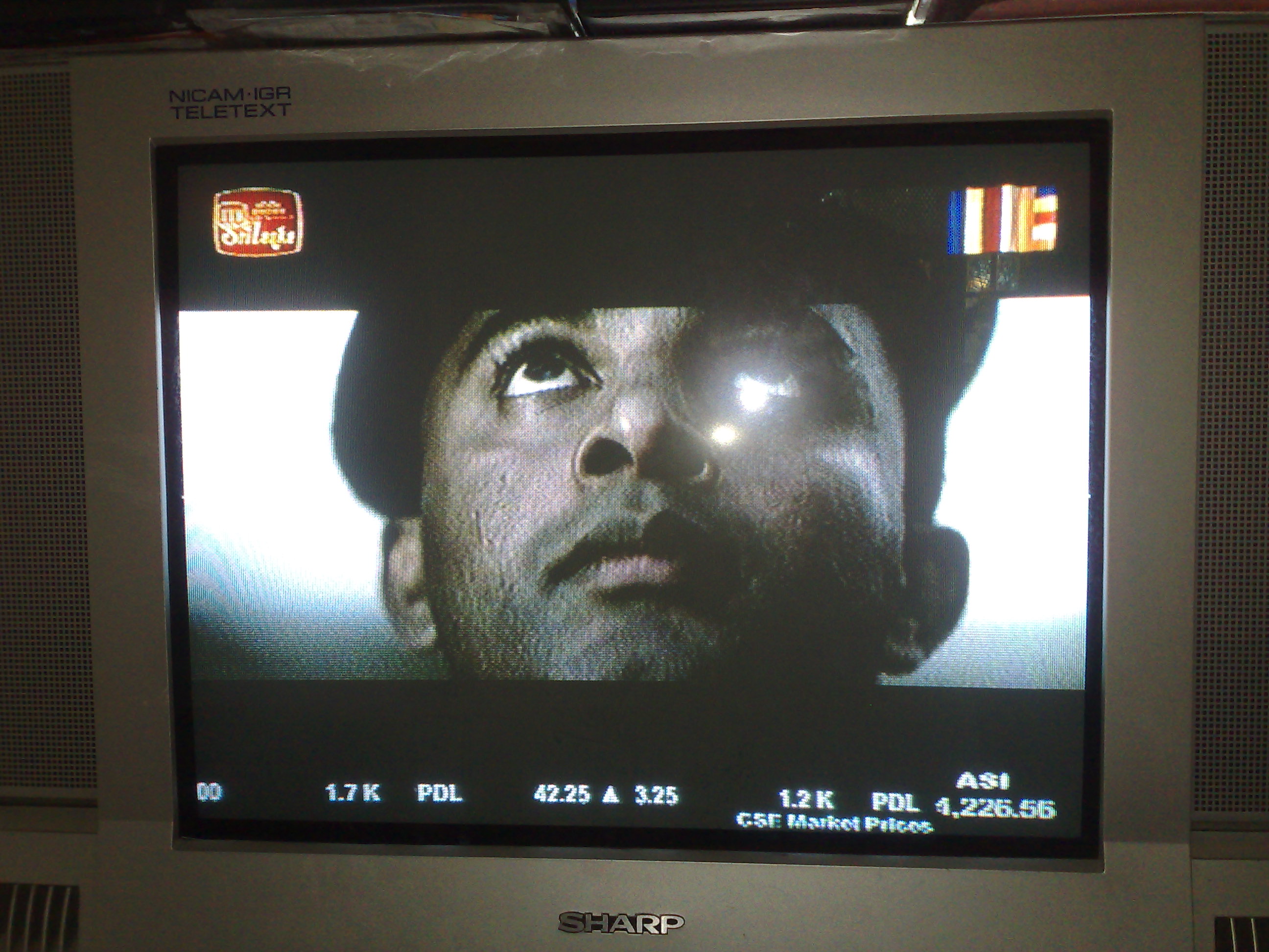

here are couple of pics, my issue in not visible in these but when u watch a sport eg.. a cricket match u cant see the score coz its covered in the bottom.. when u watch a news channel i cant view the instant news bar which is in the bottom.
I had a look at the pictures. There are no visible component issues ie: your TV internally parts wise is fine. As you said originally it needs service adjustments to get the picture's horizontal and vertical geometry correctly set up.
