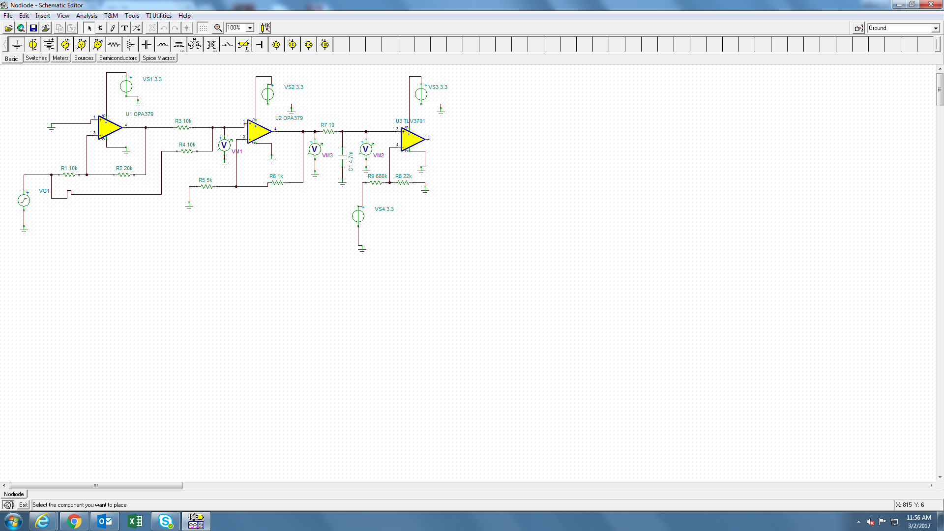

hello,
I have a single supply(3.3v) available in my circuit. I have an ac input current coming in the circuit ranging from 0 to 350 mA. I have a burden resistor of 10ohms,2 Watt connected across the ac input. Across burden resistor ,I get an equivalent vrms. I need an ac to dc conversion circuit to convert this vrms into dc voltage using single supply opamp. Please do not suggest a diode. I have designed a circuit using opamp and a bulk capacitor but it is taking time to smoothen the dc voltage. The ac input current coming to the circuit has to be detected within 100ms but this circuit needs the input to stay for more than 200 ms. can you suugest some alternative circuit solution?

1) First stage does full wave rectification, second stage converts rectified voltage into dc voltage,capacitor smoothens the dc voltage. Please neglect fourth opamp stage,it is just a comparator.
voltage source is 3.3 v and not variable.
2)0 to 350 mA ac current is rms.
3) rms current is ground referenced.
4) 50 hz is the frequency
5) Yes, we can change the burden resistor value but it should accommodate the current range.Not to forget-the supply voltage is 3.3v only. This is a battery powered device...Power saving is needed.

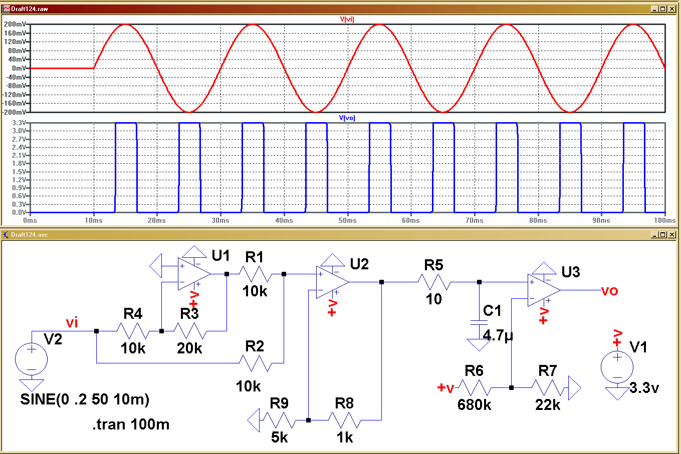

hi may,
This is what LTSpice shows for your circuit, the comparator threshold is approx 0.18v
E

hi may,
E
No sir,please do not consider the comparator part. I have put it by mistake. I just want you to consider U1&U2. I want to convert rms current to smooth dc voltage.
The OPA379 opamp has very low output current when it is powered from only 3.3V then the capacitor takes too long to charge. Reduce the value of the capacitor so it charges faster.
The output of the second opamp discharges the capacitor about half of the time. Add a diode.
Those two requirements are mutually exclusive.
You can't get a fast response if you want smooth DC voltage.
I have added a diode after second opamp's output and have even reduced the capacitor's voltage to 470uF.This also seem not to be working.
470μF will take all day to charge. Use a much lower value like this:
