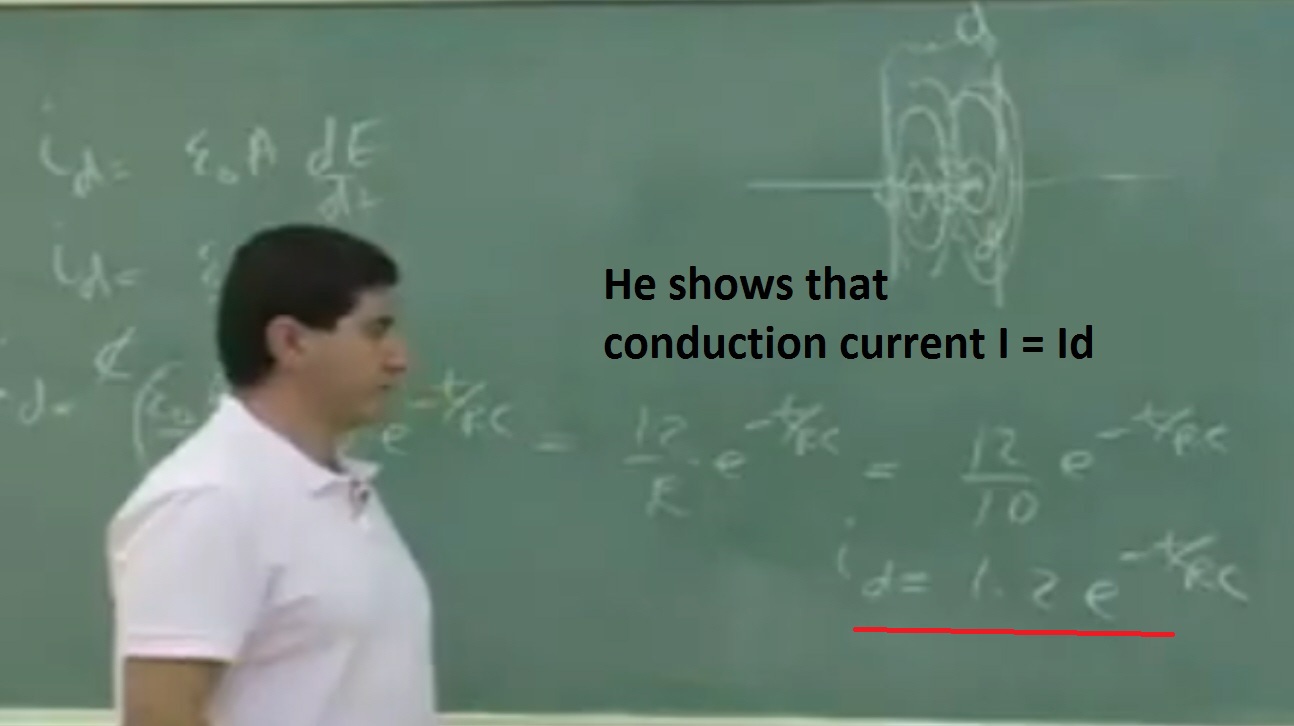

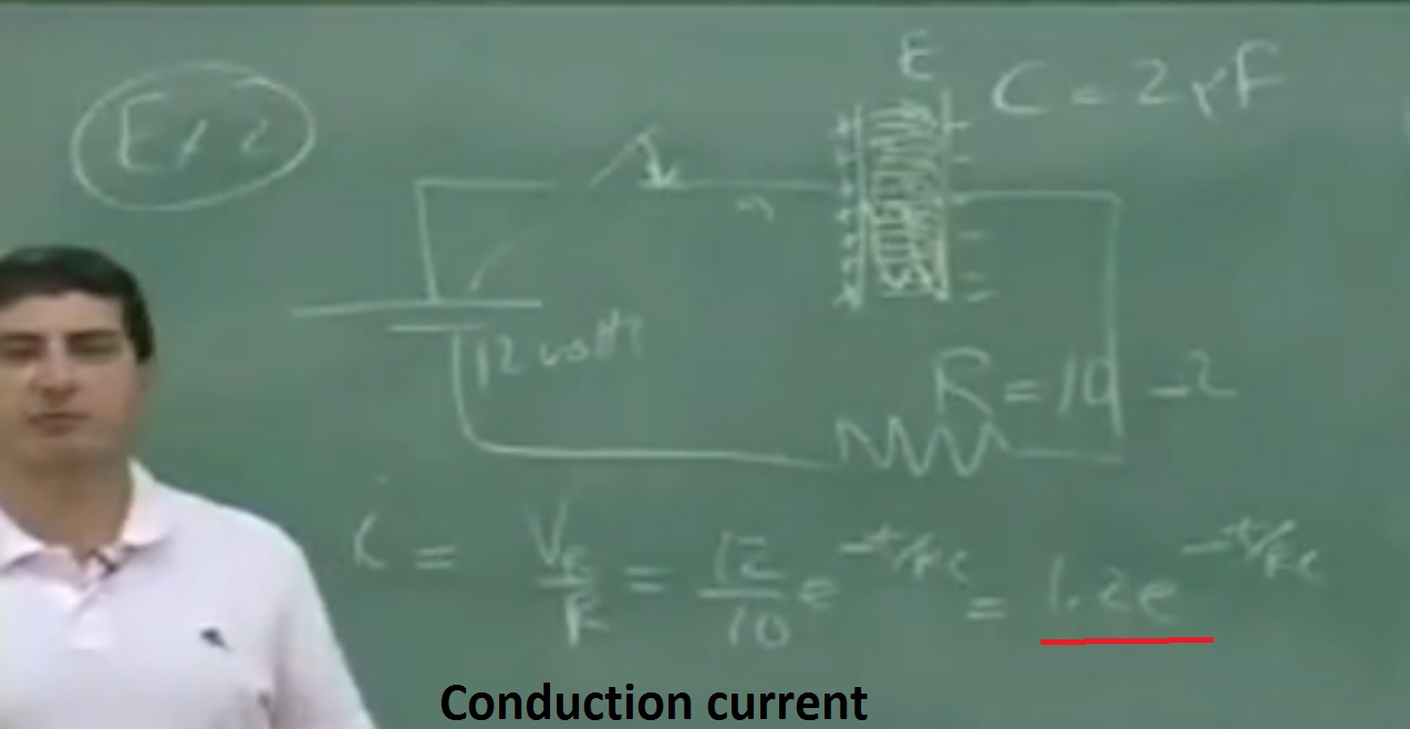

Did you look at his Displacement Current Example 2?
He concludes that the conduction current I is equal to the Displacement current Id.
You are assuming that current has to be the movement of charge carriers.
As I said originally, we need a wider definition of current. See post #86.
Yes, it is there in the mathematics. I played the lecture again and listened carefully. I did not hear him say that the displacement current was a conduction current. He did say that the displacement current was caused by a change in the electric flux density with respect to time, had units of current, and was very small. As far as I can see, it is a mathematical artifice used to make Maxwell's equations come out correct. That is similar to the conventional current method, where we assume all the charge carriers are positive, and calculate the currents/voltage mathematically that way, even though we know very well that the real physical charges are not positive. Other references I have read do distinguish between "conduction current" and "displacement current". They even mention different kinds of displacement current.
Now, you have heard of the the law called the Convervation of Charges, right? It basically says that all charge has to come from somewhere, and cannot just disappear. You and others think current can exist without any physical charge flow in a vacuum or a tight dielectric. Others accuse me of changing the definition of meanings, but that belief is a real mind snapper. Current is charge flow, and to have a physical current you need a physical charge to move. You should also notice in the second link that the author avers that the displacement current theory does not work well in antenna design.
One final thought. In your studies you have come across Kirchoff's Law, Gauss's Law, Lenz's Law, Newton's Law, Ampere's Law, etc. I have never heard of displacement current being referred to as a law. It is referred to as a theory, or just "displacement current". Look at the title of the lecture.
Ratch

He showed that Ic = 1.2 Amp & Id = 1.2 Amp.
