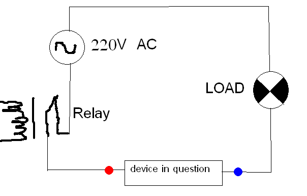

Hello,
(please look at the picture attached before reading)
When the relay ticks, i want to know if there's an attached load or if that load is actually working.
In order to do so, i want to detect the presence of a current.
I don't want to use a current transformer because i have little experience with it and it will be connected to a digital pin on a micro.
So i thought of a "device in question" that will:
*hold a voltage on its pins between 2 to 5 V (something that could be easily amplified with a transistor to reach 5V for the micro to handle)
*without causing a great limit in the current flow
(like a diode in DC circuit, it will hold 0.7V on its pins)
This is were I need your help: how do i adapt the diode concept to an AC circuit? (AC @ 220V)

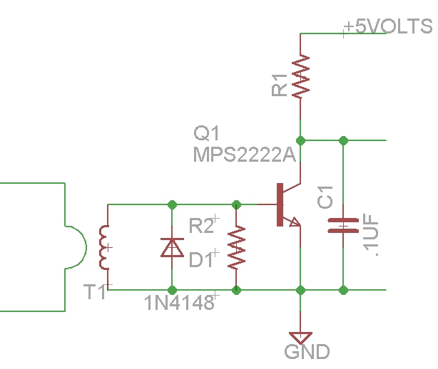

I think you should rethink the current transformer idea.
R2 is optional if the transistor is too sensitive. (100 ohms)
R1 is a pull up resistor of 10k, or about any value.
T1 is any 60hz C.T.
The output is low if there is current flow.

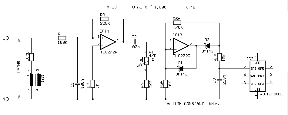

Hi trennonix,
why afraid using a current transformer?

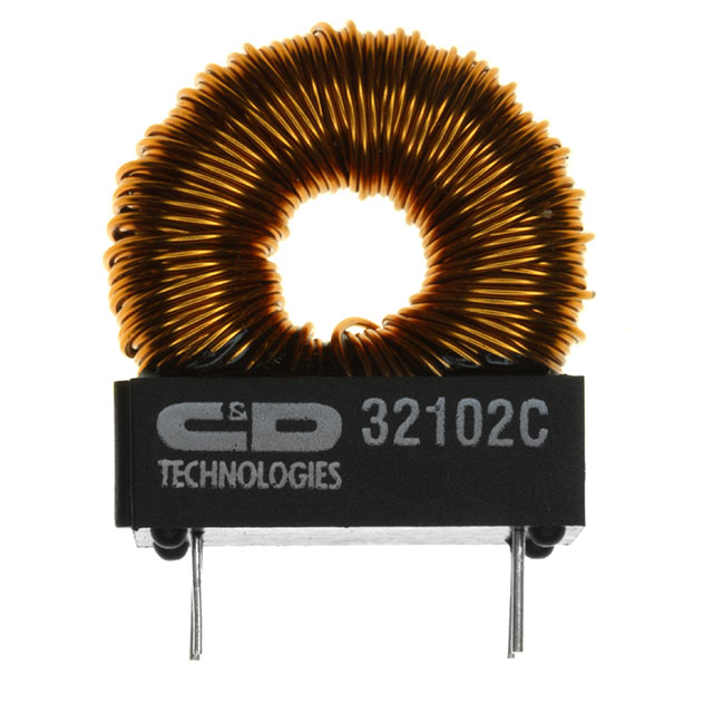

It can easily be made using a toroidal coil as used in dimmers. Add four windings of flexible (insulated) wire for a secondary winding. (see attachment).
The power loss for the AC load depends on the maximum current the inductor can handle.
The circuit connected to the secondary winding delivers an output directly to the MCU.
The overall amplification factor is aproximately 1,000. If that doesn't suffice increase the value of R4. R7 is added to minimize pulse shaped charging peaks.
Note: Supply pins of ICs not included in schematic.
Boncuk

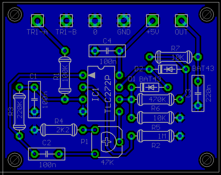

Here is the PCB design of the circuit I suggested.
The board is purely single sided and measures 1.8X1.4".
If you're interested leave a PM. I'll send you the Eagle files.
Boncuk

If there are "unknowns", e.g. the AC load current it's better to use amplifiers. Last not least the circuit output can be connected directly to an MCU without having to worry about insulation.
Boncuk

Ron Simpson's circuit will work well if the signal from the current transformer is strong enough. (turns ratio)
My circuit already reacts if only 0.1mV are present from the current transformer.
Boncuk

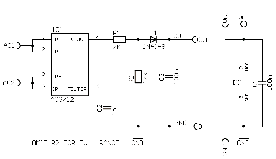

Here is another option that I've used before. They work great for both AC and DC. Isolated, 0-5V outputs, easy.
The best idea yet! :)
Accurate and low component count.

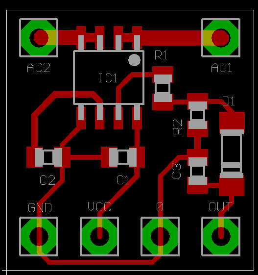

Here are schematic and PCB layout. PCB measures 0.66X0.69"
Boncuk

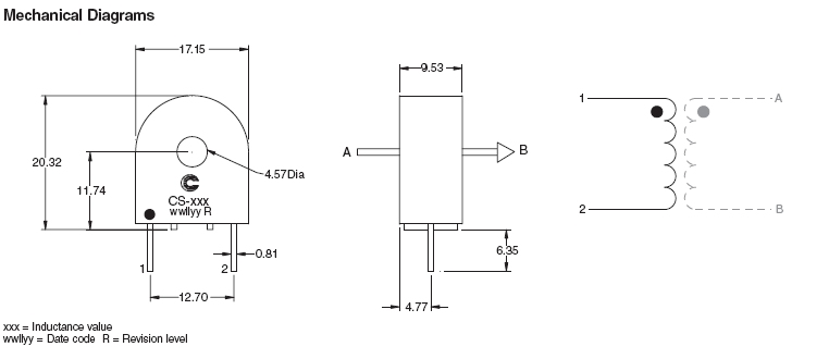

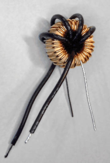

There are several good ideas presented here.

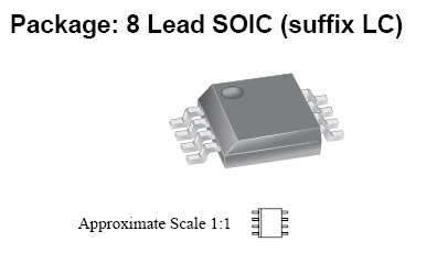

Two of the ideas require cutting the household wiring and soldering to the wires. I don’t see you soldering #12 wire to an 8-soic. (see picture of ACS712)
I use the CTs because I have many, and I don’t have to touch 220VAC. I pull the wire from a breaker or switch, run it through the CT and put the wire back.
While I use real current transformers, I found a box full of ¾ inch toroid coils with many turns of very fine wire. (thank you used electronics store) It looks about like the last picture but with very fine wire. (500 turns)
As to the sensitive of the circuit, it has to do with the turn ration 100:1, the secondary inductance, and the load on the secondary of the CT. I just built one and tested it. What is your load current? I am test if a pump is on or off. If you want to measure 0.1 amps then you need some gain. (op-amp)
