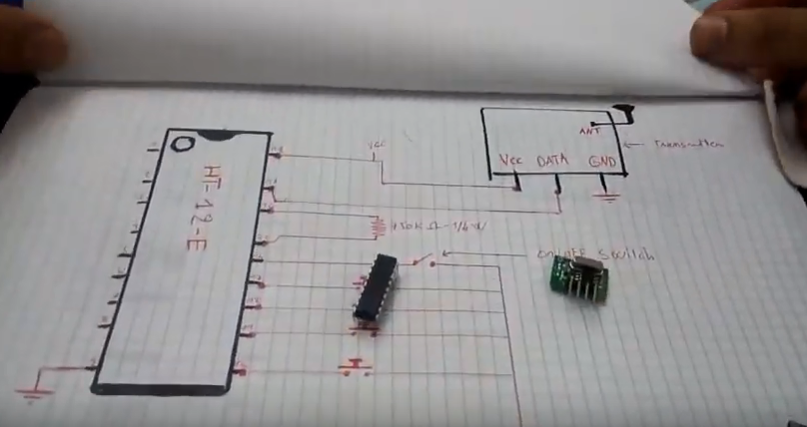

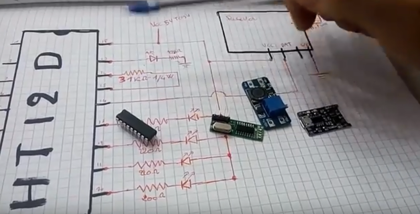

i just wanted to make a simple wireless circuit using rf transsmitter without arduino or even programming . I have seen many videos using Rf transmitter 433Mhz module , HT12E / HT12D coder /decoder and other components , but as i said they didn't use arduino so they used only 4 channels of the coder and decoder
i just want to know why just 4 channels ? and how can i add more channels . if that is impossible with those encode/decoder , with what can i replace them to have more channels and how can i connect them ?

Why not use the same system that many radio controlled models use. Pulse width modulation. That would give you proportional control on each channel rather than just on/off control. If you only want on/off control of up to 8 channels you could use a UART each end of the link. It is many years since I last used UARTs and they were in a 40 pin DIL package. I don't know if they are still available as most microcontrollers have built in UARts and cost less than I remember paying for a UART IC.

That's a REALLY, REALLY crap way of trying to control a model car, and will be essentially undrivable.
As Les said, use a proper PWM R/C system, as used for model cars - you can buy them at very reasonable cost, and make a proper model.

Thanks for the answer but actually i am not an electronic's expert so i can not understand those technical tips.
I just wanted to apply what i have seen in some videos about a wireless circuits using rf transmitters 433 but instead of 4 channel encoder/decoder i want a bit more (6 channels for example)

It wasn't a viable option anyway, not with the cheap RF modules you're looking at using, they need specific special treatment in order to work with any degree of reliability.
What is your problem with an Arduino solution?, it's cheap and all the work has already been done for you. Size wise use an Arduinio Mini to make it nice and small.
