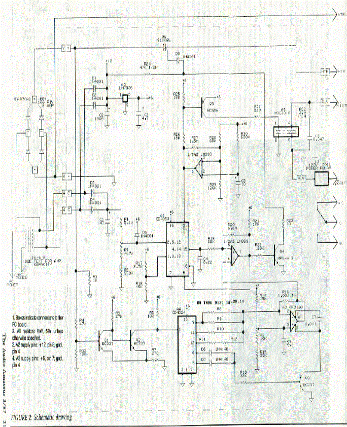

Integer control (thanks for correcting me, that is the proper name) is still the option I would pursue. Even with discrete CMOS logic, it is not that complex of a project.
I remembered that back in 1987 I built and published in Audio Amateur magazine, a vacuum tube's heater regulator utilizing integer control (see attached image). Utilizing just 4 ICs (a dual comparator, a binary counter, an opamp and an analog switch) I built the regulator and had circuitry to spare for implementing a soft start (to reduce the heater's thermal shock) and a B+ delay (to allow the cathode to warm up before the plate voltage was applied).
And sorry, but I don't have a better resolution image. This is a scan from a Polaroid photo I took from the magazine.
