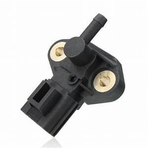

I have a modern clotheswasher used perhaps a dozen times, shiny clean pristine; parked in my basement. Developed an erratic intermittent water level failure, starting the wash cycle with a few litres of water, or overflowing to the floor, or not starting, or not stopping.
All its brains are in a single printed circuit board that includes a surface mount 15mm pressure sensor that connects the level sensing hose. Seems an atmospheric pressure sensor used in automobiles, like this without mounting holes and connector :
