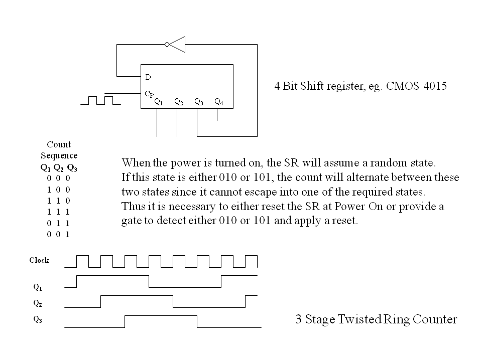

hi folks
how can i do this circuit . I will use 4 digit bcd code ..and i think i must use flip flops ..But i need the anaylsis method ..the output will be like this as 0->4->0->0->8->0->3->9->8->0->4->0->0->8....... and this mean thatthe circuit may need to stay at some values more than one period of clock ..
help please
Use JK Flip Flops & the sequential synchronous design techniques to make it count in that sequence.
However, note that you will need a Flip Flop that is set after the 040 sequence so that the counter will remain in the 0 state for one clock pulse & then go to 8 not 4 at the next pulse.
Similar logic will be necessary each time the count = 0.
Alternatively, you could use a simple binary counter with decoding to give you the required BCD output states.

I have attached a Twisted Ring Counter that uses a Shift Register.
However, I would use a Modulo 8 counter with gating to provide the required outputs.

I modified your table of figures to add the counter state numbers, ie. the numbers at the left hand side.

I have thought a little more about your design.
There are several options, I'll mention only 3 as I feel these are the simplest.
Here is an amended repeat of what I posted in an earlier post.
X Y DCBA
0 0 0000
1 4 0100
2 0 0000 Zero 1
3 0 0000 Zero 2
4 8 1000
5 3 0011
6 9 1001
7 8 1000 Eight 1
Option 1. Use a modulo 8 counter (ie. 3 Flip Flops) with gates to generate the required D, C, B & A outputs.
Option 2. Use 4 Flip Flops and use 2 states (chosen to make the logic as simple as possible) for Zero1 & Zero 2 and use gates to make the outputs zero when in these states and 8 when in the "Eight 1" state.
Option 3. Use a 4 stage Twisted Ring Counter with gates to generate the required D, C, B & A outputs.
