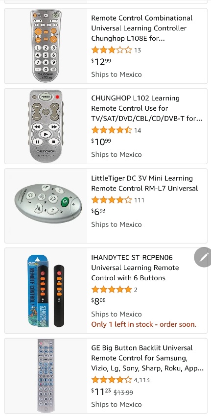

Save yourself a lot of grief, and buy a learning remote. The picture shows just a few types available on Amazon – you can get them as simple or complex as you want.
