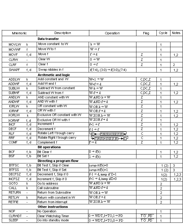

PIC Assembler Commands
PIC assembler only has 35 commands (and many of those are rarely used), so it's not too hard to learn
Are you mean these 35 commands from the figure below? :roll:
Re: PIC Assembler Commands
Yes, they are the ones 8)
If you look at my first tutorials you will see how few of them you need to actually do something.

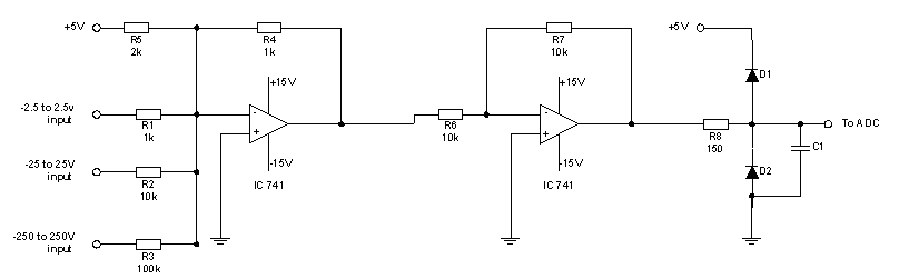

Analogue Circuitry Diagram
This is the circuit that I found on the internet. Its purpose is to ensure the input voltage to the ADC falls between 0 to 5V. 8)
From the figure below, the first op-amp is designed to change the input voltage so that it does not go over zero volts, for example changes -2.5 to 2.5V, to -5 to 0V. The second op-amp is configured in negative amplifier mode with a gain of unity changing -5 to 0V to 0 to 5V. The third part with the two diodes is for protection, e.g. say a -1 to 6V signal makes it through the op-amps the diodes will cut off the peaks of the waveform making sure no damage is done to the A2D.
:arrow:
Can this circuit able to operate for the largest input voltage range -250V to 250V :?:
Is this circuit sufficient for my project at the input stage? (to step down the input voltage to 0-5V) :roll:
Should I used any variable resistors? :!:
Instead of 3 inputs, can I have only one? (i.e. to select different range of voltage) If can, HOW? :idea:
Just remembered something I forgot, you will need a low-pass filter on the input stage, it's vital that your sampling rate is higher then the maximum incoming frequency - at least double, preferably more!. Otherwise you get anti-aliasing distortion which will complete ruin any readings.
The low-pass filter that Nigel had mentioned, where do I need to put? Before this circuit OR between this circuit and the A2D?
Re: Analogue Circuitry Diagram
If you're using a PIC A2D, you don't need the protection diodes, they are already built-in to the PIC.
Yes, no problem - but make sure the 100K resistor on the input is suitably rated.
Yes.
As long as you use 1% resistors, you shouldn't need any.
Just include the input resistors for the value you want, leave the rest out.
You could make the second opamp stage into a lowpass filter, as long as it inverts - if you use a non-inverting filter, you could add it either before or after the second opamp.
Confirmation
Sorry!! I think I have missed out some qustion. :shock: For the analogue circuitry diagram (as shown in previous post), is it necessary to include the capacitor C1 in the circuit (last part of the circuit)? If YES, is it acceptable for 100µF?
As for the low pass filter - RC circuits, is it acceptable for R=1000kΩ & C=1µF ? If it is not acceptable, can you please suggest suitable values for me? Is the resistor for the RC circuit has to be 1% resistor?
Thank You!! :wink:
Re: Confirmation
100uF would be far too big, you don't need a capacitor there at all, a PIC A2D already has a sample and hold capacitor.
It all depends on how fast you are going to read the incoming signal, a simple resistor capacitor filter is probably not good enough, you should make the 2nd opamp into an active filter at about 1/5th of your sampling rate.
