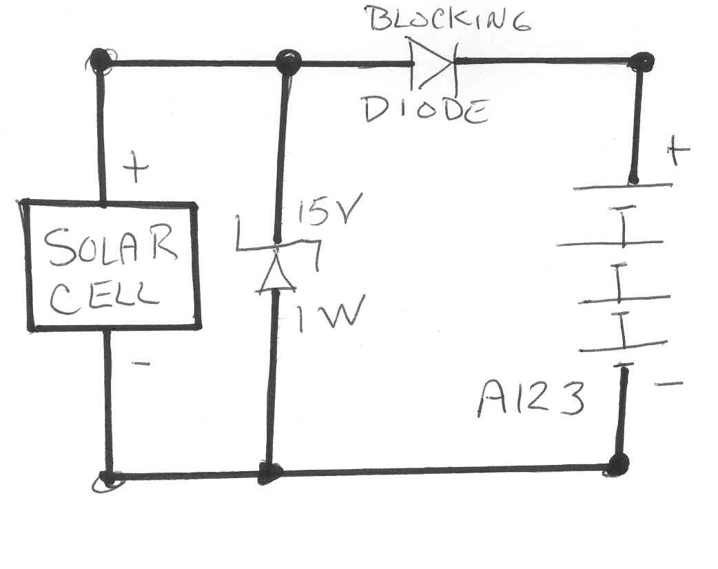

browningbuck, This simple circuit might work to regulate the Max Voltage as the Battery becomes charged. Prototype it. Put the Solar Cell in the sun. Connect the battery (put in shade). Then over time use a DVM to measure each cell to make sure none goes above 3.6 - 3.7 Volts as overall Battery Voltage approaches 14.4. It should then Float at 14.4V and hold the 4 Cell A123 at full charge. Report back how how long it takes to get to 14.4 Volts or if it exceeds 14.4V or never reaches 14.4 V. The Zener will get warm if the Solar Cell is in the Sun and Battery is fully charged or no battery connected. If you change the Solar Cell with one with more ma then you will need to increase the Wattage of the Zener, too.
OK ?
Where can you buy a zener diode that has the accuracy needed for charging a lithium battery?
How will you balance the charging so that each cell charges to the same level?

There is an easy way to either increase or decrease the Max Voltage across each cell by approx +/-0.1 Volts. That is why I asked browningbuck to prototype this circuit, turn it on and then actually measure with DVM to see what happens. After the measurements, then we can make a simple adjustment, if needed. Browningbuck used these words: "simple" and "easy". Lets not over complicate this design.
The Solar Cell purchased produces only 420 milliwatts. My all passive (easy/simple) circuit consumes 35 milliwatts leaving about 400mw to charge the battery pack (almost 92% efficient).
Given that the A123 is not being discharged at 5 - 10 Amps nor being recharged at 5 - 10 Amps (more like 16 - 34 ma), I do not think cell balancing will be an issue.
Can you design and post a (easy/simple) "Balanced" 4S A123 Charger that actually runs from the 12V 34ma Solar Cell, is over 90% efficient and does not discharge the battery when the Solar Cell is dark? That is quite a challenge.

I have never seen a battery charger circuit that balances the charging of series lithium cells. Maybe Maxim has an IC that does it.
