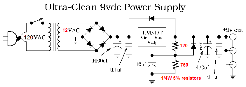

btw, whats the maximum amperage output of this supply going to be after the changes?
is it the same max output of the 2A transformer?
The transformer is rated for 2A AC. The supply will make 17VDC peak at the main filter capacitor so its DC current is only 1.4A when the transformer is at 2A AC.
The LM317 is rated to regulate very well with no more than a 1A load but some can give 2.2A if it has a big enough heatsink.
If the regulator gets too hot then it shuts-down to protect itself.

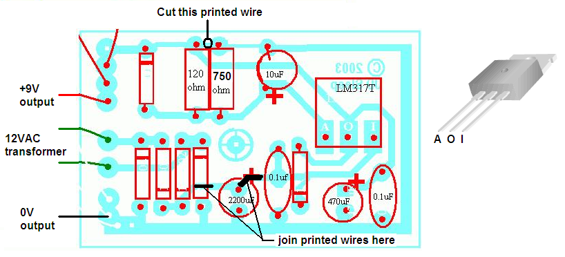

moody07747 said:
well i got those 2 resistors in place and im not getting any output voltage at all.
When you removed the two extra resistors from the pcb layout, you shorted the output of the circuit.

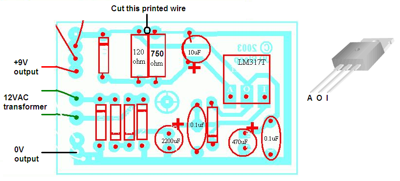

moody07747 said:
nope still no output...next step?
is it possable i burned up the regulator when testing with that short the first time?
if so i can replace it with another.
The regulator with a shorted output gets hot then shuts down to protect itself.
Join a couple of spots on the pcb.
moody07747 said:
fixed it, at first it didnt work...untill i took the green neon light out of the electrical path on the switch.
for some reason it wont work with it.
im getting 8.95DCV, plenty good enough
A neon bulb has a resistor to limit its current to only about 1mA. It doesn't go in the electrical path in series with the transformer, it goes in parallel with the transformer's primary.

Somebody tried to make that crazy power supply project last year. Wasn't it you, Moody?
It doesn't need four 1% resistors, it just needs two ordinary 5% resistors to make 9V.
If it was under my name, than yes it as me.
This is the original pedalboard power supply thread if thats the one you're refering to.
I got power to the board and its comming out at 8.97vDC,,,well enough for my pedalboard.
But 1% resistors are the same price as 5% resistors so I used them anyway.
