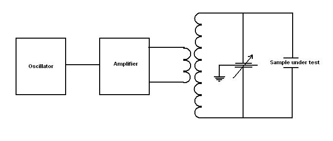

Coming a little late into this discussion, can I suggest something which should be quite easy, if you can find the parts.
Have a look at the attachment.
The sample under test is connected across a parallel tuned circuit which is resonant at the frequency of interest (1 Mhz ?).
I have shown the capacitor as a "split stator" type, so that the adjustment control can be at earth potential.
The oscillator can be whatever you have available, the amplifier I was thinking of using a valve (tube for those across the Atlantic).
The valve amplifier will work with high voltages without any problems, and link coupling the amplifier to the parallel tuned circuit will give you plenty of volts across the sample under test.
JimB, this is brilliant! It's exactly the kind of thing I was looking for! I have to admit the tube/valve thing is a tad daunting to me, not being an EE, but really this seems like precisely what I need. Maybe if I do some homework and figure out how to use valves beyond mere theory I can make that guitar amp I've always wanted to make. Thank you!

I had looked into using a spark gap, but like you said it doesn't work for this. I managed to source some fet modules that will handle the amplifier stage. They were pretty expensive but as this is only a one-off research apparatus and not a production piece, it was tolerable. I did look into using tubes for the amp, and they're vastly less complicated than I had thought, but the fets were still easier to implement.
