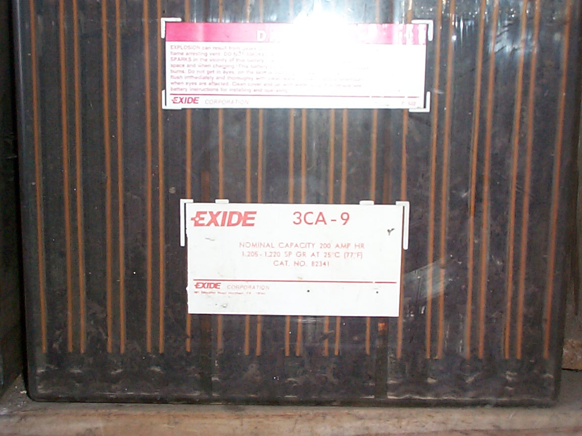

You know any one that wants to buy ten 6 volt 200 Ah Exide industrial storage batteries? $25 each you haul them! 8 are still in great shape! two have cracked cells at one end. The wood cabinet is included!
they will be cleaned up and tested before pickup and I will load them too!
(The salvage dealers will pay $25 each too so they wont get any cheaper.) :)
