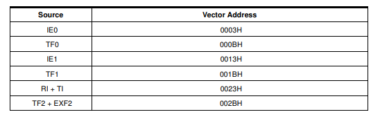

You also want to focus on interrupt routine entry points. Good coding practice will have error safe recovery for unexpected interrupts that are not being used. Actual interrupt code as well as EI and DI instructions (or their equivalents) will be useful things to find.
Here are the interrupt vector addresses for the basic 8051. Your variant may or may not have others.
There a two ways to interpret this:
1. the interrupt address holds a vector, i.e. an address to jump to
2. the interrupt routine is executed from the address jumped to.
The documentation isn't all to clear ..
In the case of the 8051 architecture, the intention of the original designers was that there should be actual code located at the vector addresses. That is partly why they are not at contiguous and adjacent locations. It is also consistent with the 8080/8085 architecture which was contemporaneous with the 8051 and it's predecessor the 8048/8041

The address 0x0003 is jumped to when external INT1 occurs, supposing this is used, the code makes no sense.
supposing INT0 is not used, the code makes no sense either.
Could you please reply to the question itself, instead of mimicking chatgpt?
Address 0x0000 should be something like a jump.

What makes me wonder, is that 0x0003 and 0x000b are the places where IE0 and TI0 are located.
The way I understand the manual, the PC is pointed to these addresses, instead of loading a vector.
But suppose IE0 was used, than jumping to 0x0003 yields the same nonsense:
