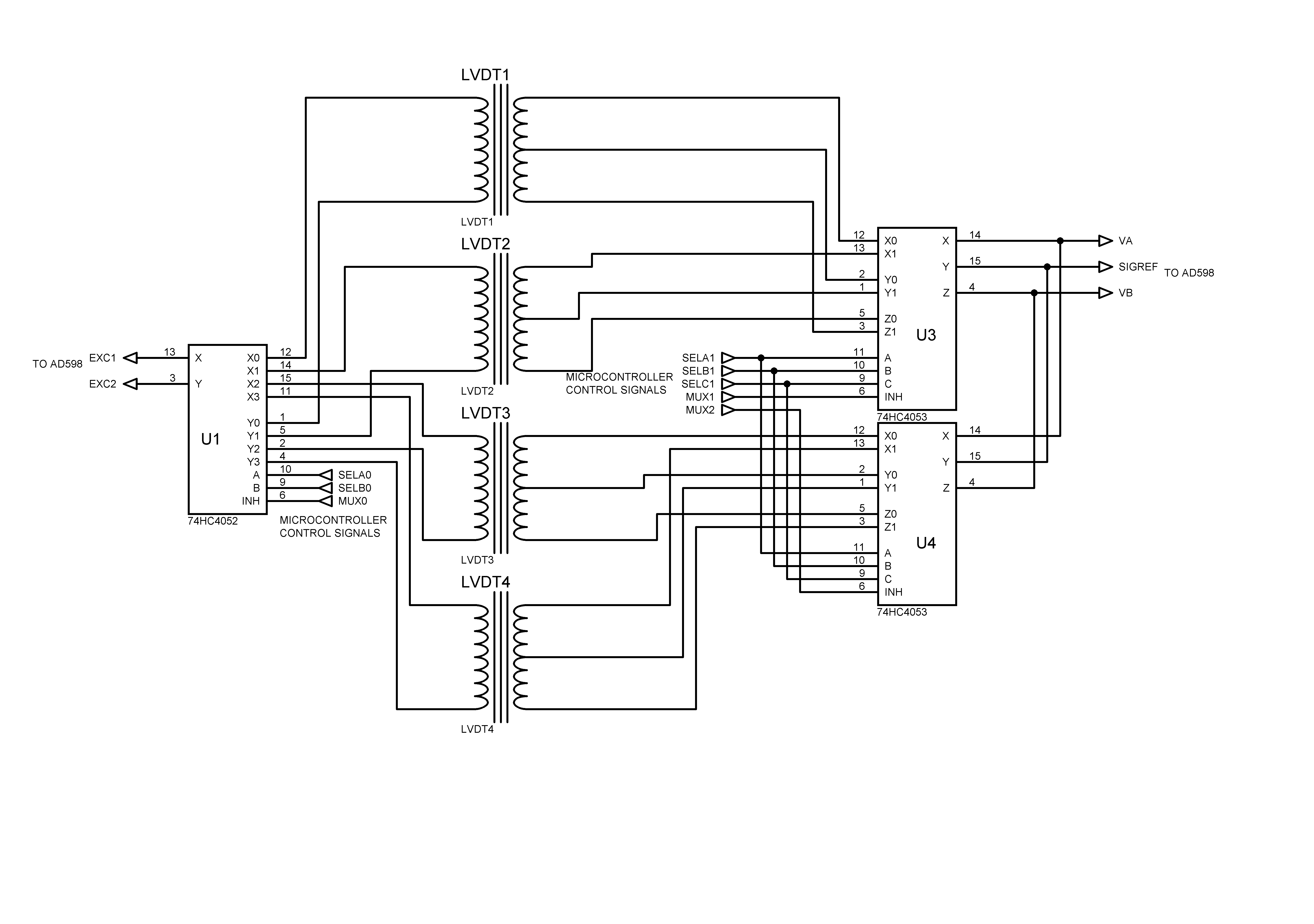

I am planning to develop a system which will measure 8 channels of 5-wire LVDT signals.
Initially I was planning to use 8 no's AD598 and sync them to eliminate the beat signal but the cost and availability of the IC led me thinking in an other direction. On the AD forum somebody suggested about using ADA2200, but again this was with 8 no's of ADA2200.
I plan to multiplex these 8-channels to a single AD598 and read it on a Microcontroller 12-bit analog channel.
I am looking for guidance here with some reference material or some schematic concept with few recommended parts. If anyone can comment, it will be great.
I also am unable to understand how will the zero offset for each LVDT be handled.
I will poll each LVDT and I want to finish the process in 3 to 4 seconds. It also involves stepper motors to drive the LVDTs on some fixtures.
Please make me understand how I can acheive this.

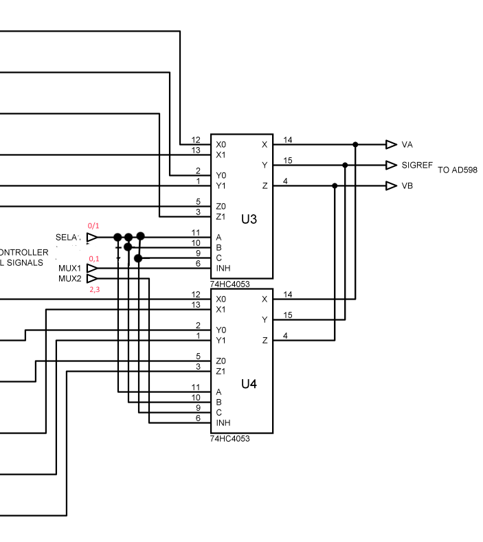

Please find a scheme attached here, which i was thinking to use (using multiplexers) where I will use a single AD598 , and switch the primary and secondary of the LVDT with the help of Multiplexers.
Will this work?
If not , can some experts guide me in the right direction?

I would think about connecting all "sigref" together.
Add a second 74HC4052. Connect A to A, B to B, INH to INH.
119522
What it the voltage range for the signals? Will they be with in the range of the HC4053? Will the signal ever go below ground or above +5V?

Why do you think that the 4053 won't work?
Why do you want to combine the ref Sig directly to AD598?
I see people that want to mux analog signal and don't know the range for the HC4053. There is also a CD4053 that will work up to 15 volts. I just want to know if you understand there is a voltage range and there is some resistance added.
Because; then you only have to mux two wires not three. Less parts. Only use one type of part(s).

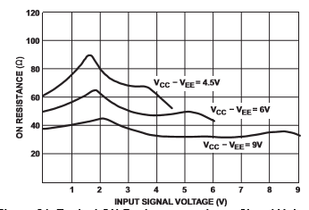

74HC4053 from TI.
When the switch is closed it has a resistance of about 70 ohms when powered from 5 volts. Vee=0V
119523
Resistance (on) verses signal at different voltages. Note; Vee can be -5v to allow switching from -5 to +5V.
I think your signals will be within the supply range. (did not check) I think, on the receiving side extra resistance will not effect anything.

I would use two 4051s on each primary side.
Use two 4051s on the secondary side. (connect all the common/center taps together)
On the addressing; connect all the A(s) together, all the B(s) together, and all the C(s). Inhibit=on. Very simple interface.

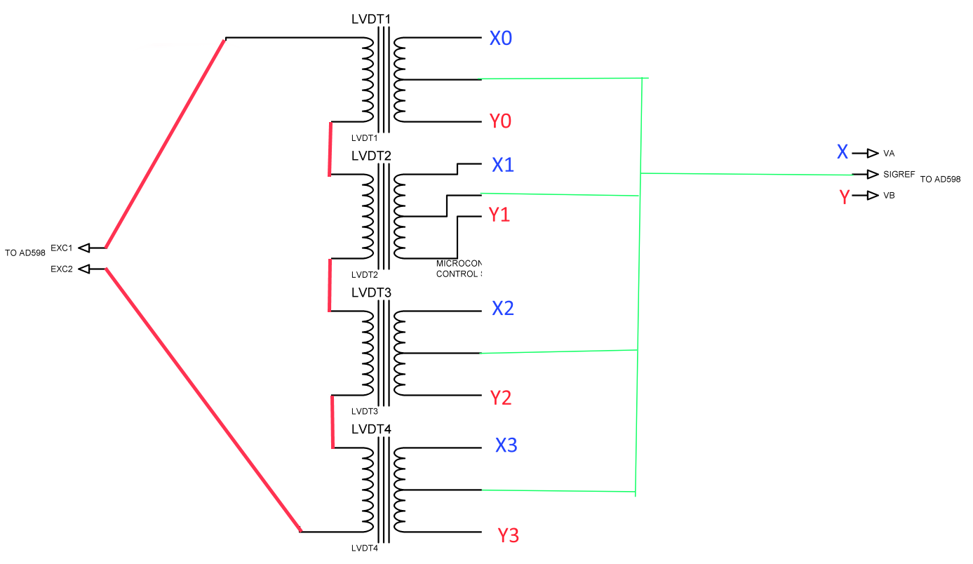

1)You need to look more at the voltages! The AD598 can output 2 to 24 volts rms. There is a resistor to set how hard the outputs drive. The HC4051 can not do 24V!
2)I think the output can drive above and below ground. With a +/-15V supply the outputs can pull up and down a long way. I think you need to have the HC405x set for +5V ground and -5V. You need to work with a negative signal.
3)You need to find out what the input side looks like. I think it also is above and below ground.
This is why I keep saying watch out for the voltage range.
What is wrong with the 4051? Which LVDT? Part number--it is important?
Because the AD598 can drive very hard: series up the transformers and kill the mix.
The IC can drive +/-11 volts. (say 10V) 4 transformers in series = 2.5V each. (4 series) in parallel with (4 in series)
119525
On the IC pin 17 is often at ground. So the signal will swing + and -. So the mux must have a +5V and a -5V supply. I do not know how big the signal will be but I think less than +/-5V.

4051 is an 8x1 mux , whereas I need something like 4052 or 4053 as shown by me.

Isn't it the same thing as using 2 nos of 4052?
I am still trying to understand if connecting 4 series LVDT primaries will work. Never seen anyone doing such a thing.
If the IC can drive large amounts of current you could connect all of the LVDTs in parallel.
I could not find out how much current because the data sheet is missing information.
