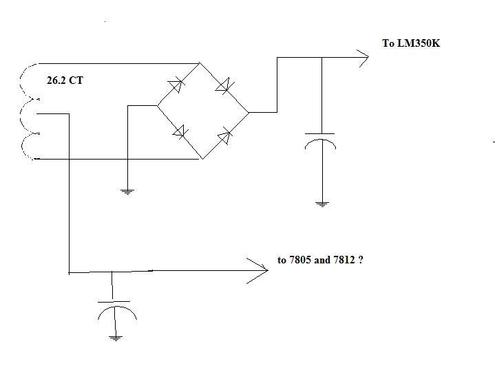

Another thought. To minimize power dissipation for the fixed 5V and 12V outputs, you can use the transformer center-tap to get a 13.1V full-wave rectified signal. Just add a filter cap to the center tap and you will get an output of about 16-17V DC. This works because the bridge performs double duty, acting as a two-diode full-wave rectifier for the center tap and well as a 4-diode full-wave bridge for the two main outputs.
Thanks Crutschow
I briefly considered using the center tap but thought I would need to move ground or cause a short. Attached is a schematic....would this be correct? That would be a much better way to go, if I understand correctly.
I do want to be able to use all three outputs together ie a common ground for the 5,12 and variable.

Yes, that circuit is correct. If you look at the current flow you will see that the two grounded rectifiers in the bridge act as a full-wave rectifier for the center tap. It's opposite of the way most full-wave rectifiers are connected, with the center-tap grounded and the rectifiers on the two end connections, but it works just the same.
You only have a shorting problem if you try to use two bridge rectifiers off winding taps that are not isolated.

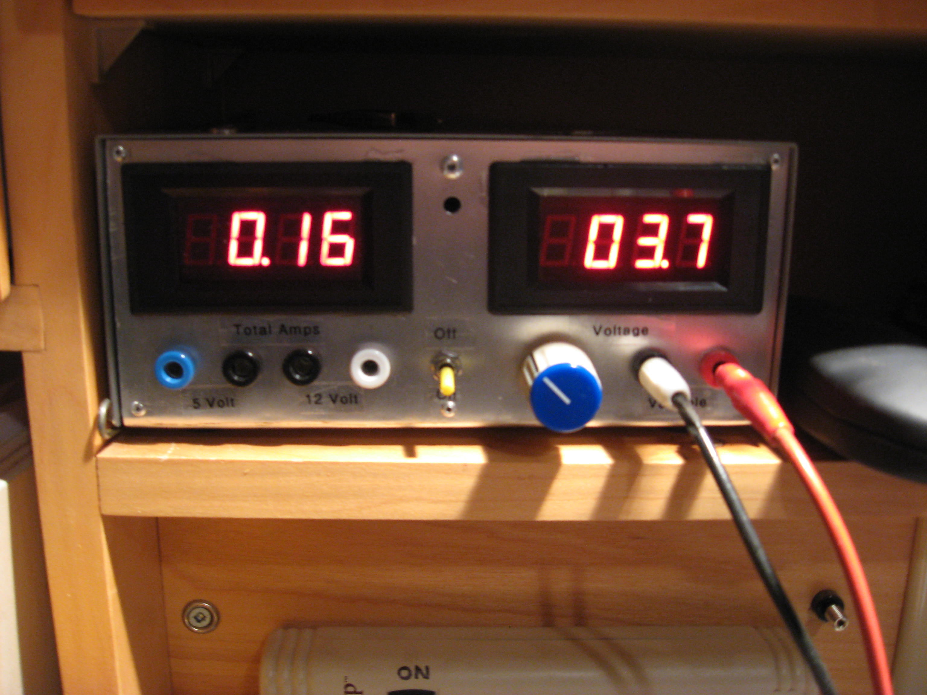

I finished up the project a couple of weeks ago and wanted to say Thanks to the replies (repliers? )
The LED meters did end up working out fine in the end. I have had them (and this project) on my mind for a long time (~10 years...) and finally got around to it.
Using the Center tap worked perfect. I have not tested it too see how much current I can draw from the 7805 and 7812 but it should be fine. I have a small heatsink on them.
This project was mainly about the power supply but climbed up the list as I wanted to practice making a printed circuit board before moving on to larger projects so all in all, worked out well.
