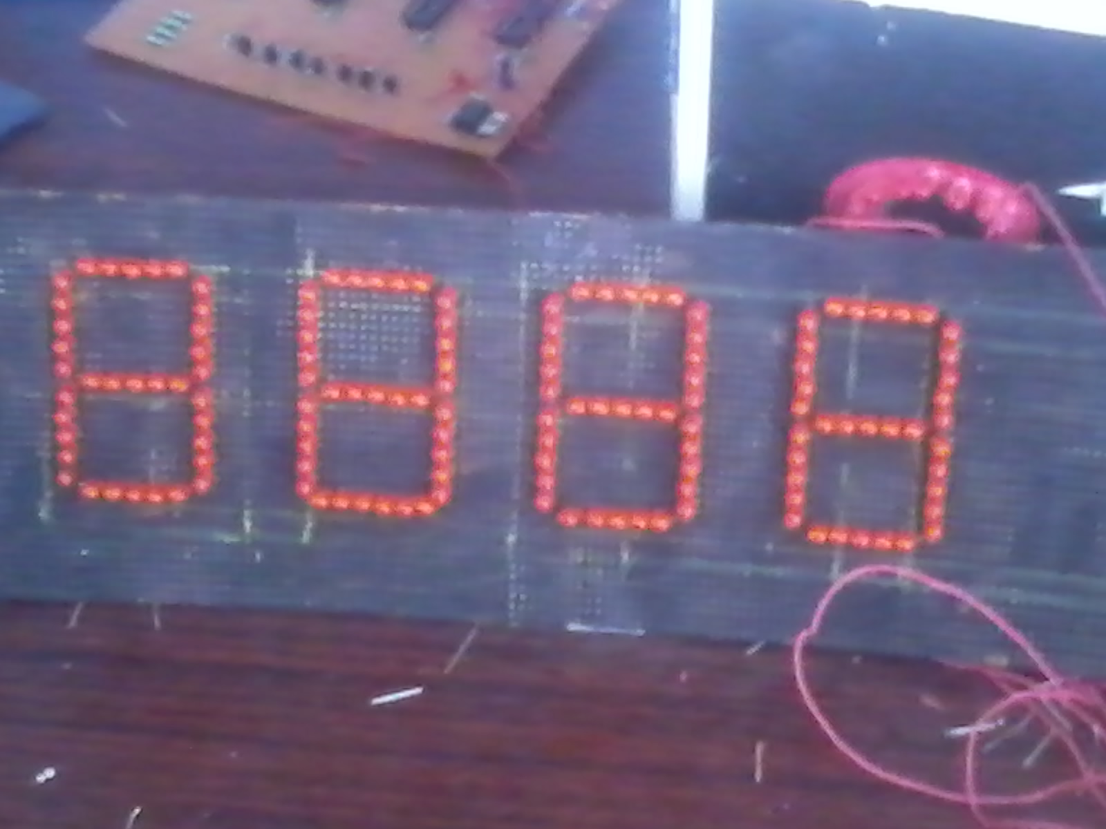

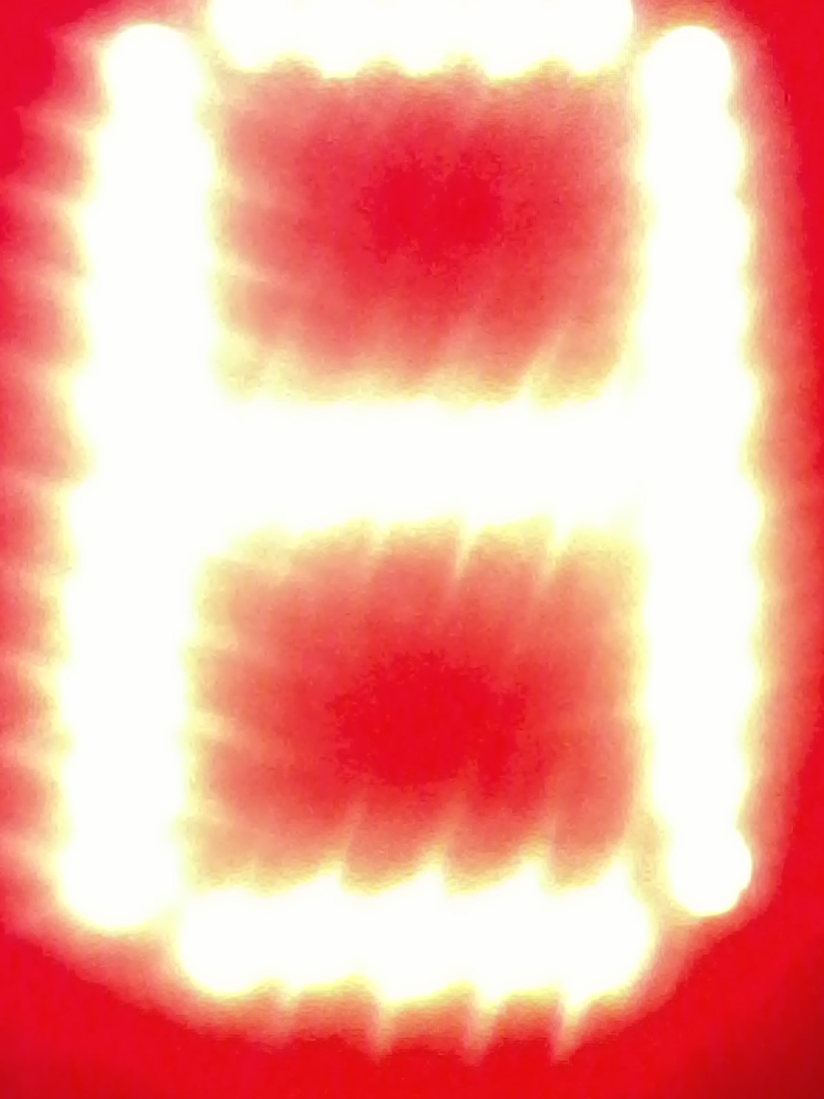

Hello,
Here is Display with 12V directly 120Ohm series Resistance taking 20mA each segment!
with 9.5V/1.9V leds
The 4511 takes 0000 and give 1111110 //0
and the ULN2003/8 will convert 1(high input) to 0(low output) and 0(low input will be give what) will convert x??
