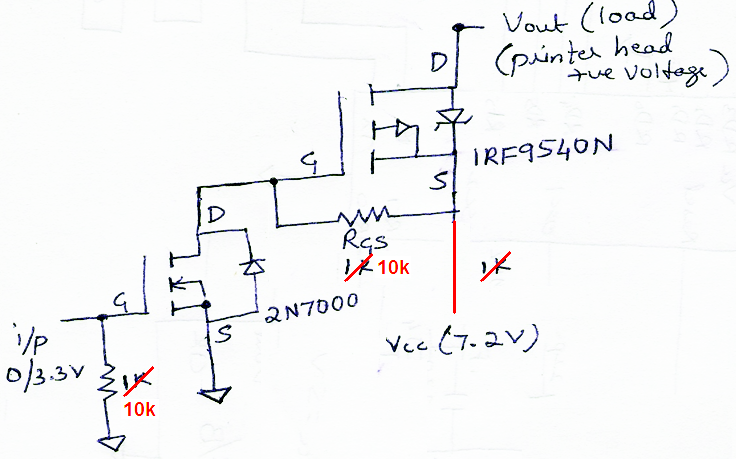

As per your suggestion. I have attached the schematic. Correct me if I am wrong with its understanding.
Giving 3.3V (Logic high from the microcontroller) will turn on 2N7000 and because its source is connected to ground, the same is given to gate of IRF9540 and this will turn on IRF9540 and we get 7.2V at the output.
When 0V (Logic 0) is given, 2N7000 is OFF and Rgs will take care of pulling the gate of IRF9540N to Vcc (ie 7.2V) thereby keeping it in OFF and the output is open.

Is 7.2V, 3Amp work with IRF9540 and is 7.2V needed for gate of IRF9540N.

You are using an RGS of only 1k for both mosfets which is too low. The micro-controller cannot drive a load as low as only 1k without dropping its voltage to maybe only 3.0V when high and the 2N7000 cannot drive a load as low as 1k with only 3.0V on its gate. Use 10k.
You are supplying the source of the P-channel Mosfet through a 1k resistor so its output is only 7.2mA into a short and 7.2V when it has no load. Get rid of this 1k resistor.
