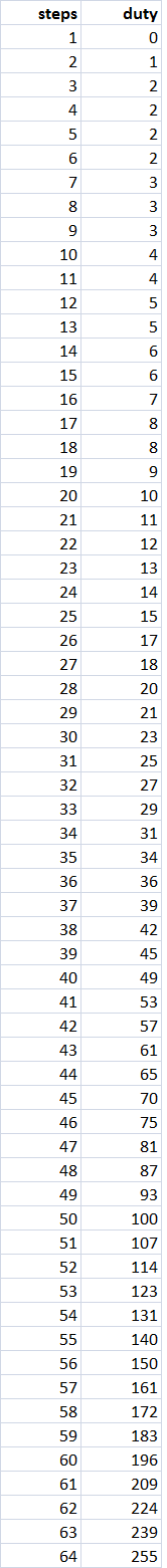

I'm doing an RGB colour changing light.It has 255 PWM steps. I'm doing interrupt driven software PWM for 3 channels.
Xtal OSC = 4Mhz
Interrupt rate is 32uS.
PWM Period :32uS X 256 = 8192uS
PWM frequency is 122Hz.
I can fade an LED from 0 to 255 steps without a problem.Now I want to add an 64 level gamma table to the 8bit PWM steps.
My problem is there is only 64 gamma values but I have 255 PWM steps,How to scale this down?
The below code hangs when "Brightness" register comes to 65 :(

Now I understood a bit.Gamma represents "smooth brightness level" sort of thing.So I have a 64 level gamma correction table over a 255 PWM steps.That means I can fade LEDs with 64 level of brightness levels.
The attached table is my 64 levels over a 8bit PWM steps.
Now the question is if I want to load a single colour let say value "Red 200" (that is not in the table anywhere) and need to fade up to full brightness.How to achieve this?How do I know which index out of 0-63 the value 200 is present?
Index = int(value/4).

Now when fading LEDs I'm using 64 level brightness register that represents 0 to 255 duty cycle values.
The thing is as I mentioned earlier I am doing a RGB mood light thing.I'm not always fading LEDs. In the mean time while fading I need to show fixed & mixed colours as well.
Ex: the colour "yellow green" 8bit values are (154,205,50).So I need to find the index values for the above duty cycles.
Index = int(value/4) is not correct as the table is not having linear values.
Whats the point in a mood light that cannot show a colour as expected :(

I have shifted my design to a 255 gamma correction method.I'll let you all the progress :)
With a gamma correction design you get really nice colours in the spectrum change.Without a gamma corrector intermediate colours like Orange,light yellow,light purple etc very hard to produce & its not noticeable to human eyes while fading.
