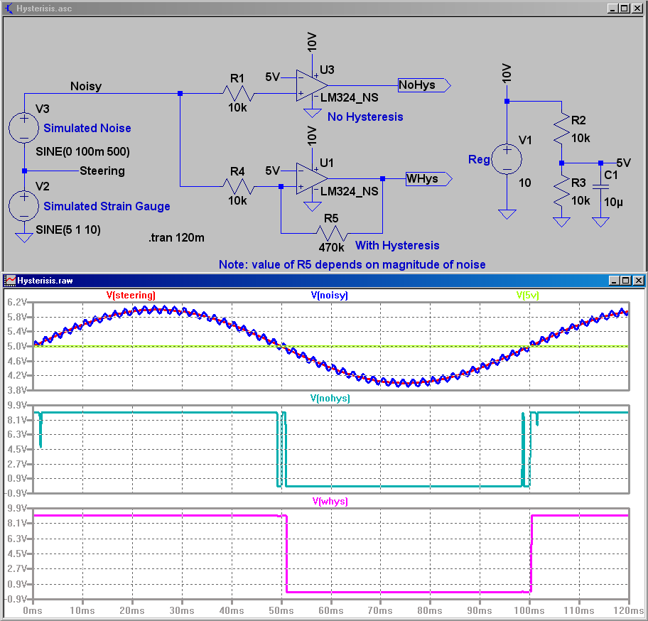

precision is not a problem...I just wanted to make thermal switch for a particular set temperature but in higher temperature ranges..(500-700 C)..so my idea is to turn on and turn off the heater around set temperature....
So, just a TC amplified by an ordinary opamp, fed to a comparator to switch a transistor/FET, which switches a relay, which switches the AC power On/OFF to the heater would work?
The Transistor/FET and relay could be replaced by an SSR.
Mike...
By using comparator-relay in comparator mode...don't you think relay will be on/off frequently which can lessen its lifetime...because comparator voltage will be precise and at that point relay will operate around it...so is there a way to set a littel tolerance band so it operates in range rather than a point...to reduce relay operation...
for example if I set t=500 C then I want it such a way that I have a bandgap of 5 degree so relay operates at 505 and 495 ...id it possible without uC...
can you suggest any ordinary amp. which can give good amplification in this case......
Sure, just use a little positive feedback around the comparator to make a small hysteresis deadband.
Attachment is from previous post on this very topic...
Yes, consider R4 and R5 as a voltage divider. Note the ratio of R5 to R4. Start with R5 very big (~2megΩ), and keep reducing it until the chatter goes away, or you have your desired hysteresis.
