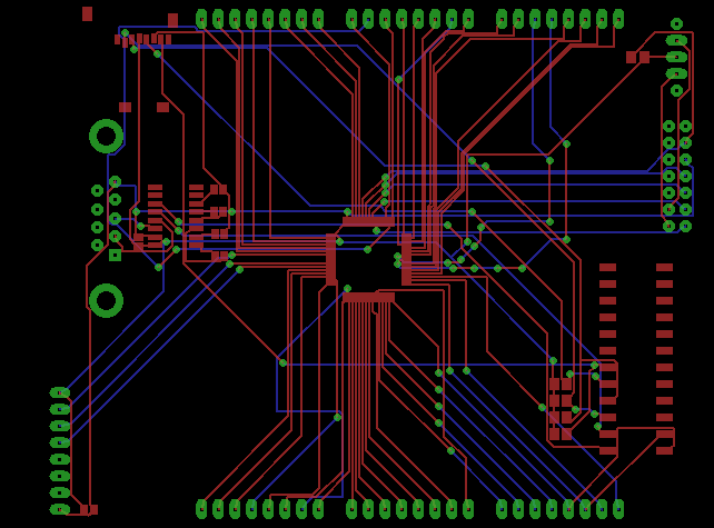

Futz, nice board. Why don't you get rid of more of the square corners, though?

I think it is still a Work In Progress. I can see 7 via's right off the bat that could be eliminated (From the center header on the lower edge of the PCB). Autorouter madness! :D

Yes, I think you are right about that. I used to let the autorouter suggest, but these days I just avoid it.:p

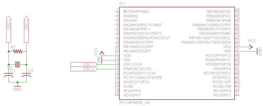

on the topic of eagle... When making a schematic how the hell do you make it like wireless on the schem?
Ok i know that was confusing. ill try to explain. Look at almost any schematic they have a tag on the pins like VDD might have a line to a <5v> type tag and then that tag it also on anything that needs the <5v> so anything that has a 5v tag is connected. You understand?
Look at bills page: https://www.blueroomelectronics.com/
see the junebug underneath it is a schematic. See the PGC and PGD and stuff under the right wheel in the picture. How do i make those in eagle?
Um, do you mean naming the nets the same as other nets, and they get connected automatically? Like a bus?

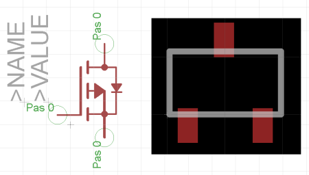

Yeah BeeBop... but it would be nice to have that little thing like a label part. Now with a N-Channel...

That was just a quick autorouter-only test. The board is far from finished. :p As I do it I'm relearning all the stuff I used to know how to do in Eagle years ago but forgot. Still a ways to go...

Found it Beebop
Under Supply 2:
V-->
V<--
COOL!

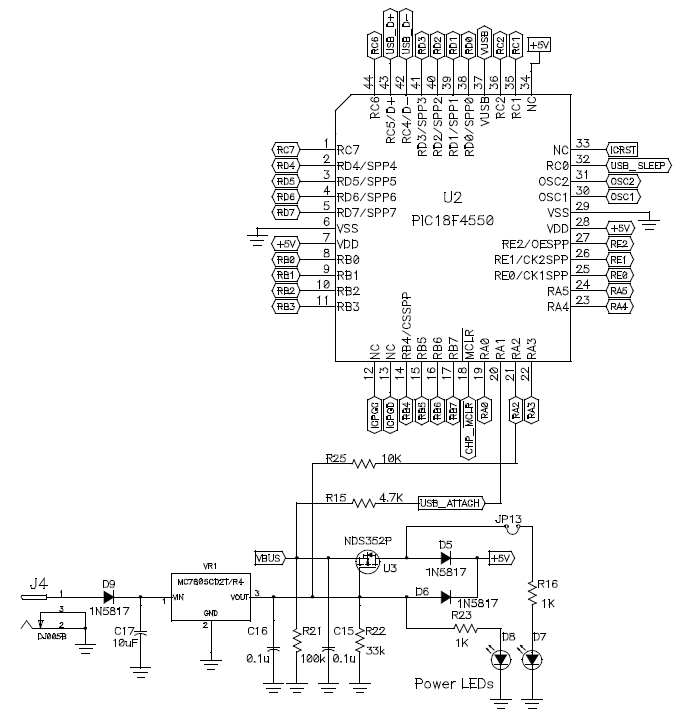

Thanks Beebop... Im looking at the PICDEM FS USB User Guide at the schematic. Im wondering what they use that mosfet for. Looks like it blocks the VBUS (+) from the rest of the circuit if the user supplies power via adapter. Would that be correct?
