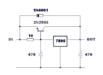

Im trying to work out a good way to turn 12v (IE car power) into 5v @ approx 6amps. I want to make it on the cheap, so Im hoping to do it with parts scabbed from old AT and ATX computer power supplies.
So far Ive found 1 7805 a few various negative 5v regulators and a bunch of high current switchmode power transistors (2sc2625 is one there is a few of).
Im under the impression that I could do a negative regulator and simply reverse the polarity at both ends. Am I on the right track here? Or am I even on a track at all?
Find a high current PNP transistor [the 2sc2625 is a NPN].
Wire it to boost the current of the 7805.
The 10 ohm resistor should be at least 2 watts.
Put the regulator & transistor on a common heatsink. [insulated]
This should give you the 6 amps.

Is there a way to do it with the NPN transistors?
I do have a 7905 around in the collection of junk.
Can I do it on the negative like that?
I have looked for a PNP, but no luck, thats why Im asking about this negative method.
Substitute the 7805 for the 7905, use an npn pass element wire it as the above circuit......this will give a neg output wrt gnd........be sure to check the pinouts of the 7905......not the same as the 7805

Mosfet, in Your circuit the 10ohm resistor i think 1ohm, because the pass-transistor must open, when the current of 7805 reached about 1A, and this voltage drop open the transistor. For 7A output current i recommend 0.8...1ohm 8...10W resistor.
As the current flows through the 10 ohm resistor, the voltage drop increases to .65 volts which turns on the pass transistor. A smaller value, i.e. 1 ohm would cause LESS current to flow thru the pass transistor. With a stong pass transistor it could be increased to 20 or 30 ohms. Very little current actually flows through the regulator.
If the regulator is mounted close to the pass transistor good thermal conduction occurs.
The thermal overload shut-down in the regulator will protect the pass transistor from overheating.
Short lead lengths will improve transient response also.
If one needs even more current several more pass transistors can be wired in parallel.
In this case change from 10 ohm to 30 ohm.
I have used this circuit with 7809, 7812, 7815 & 7824 regulators also.
