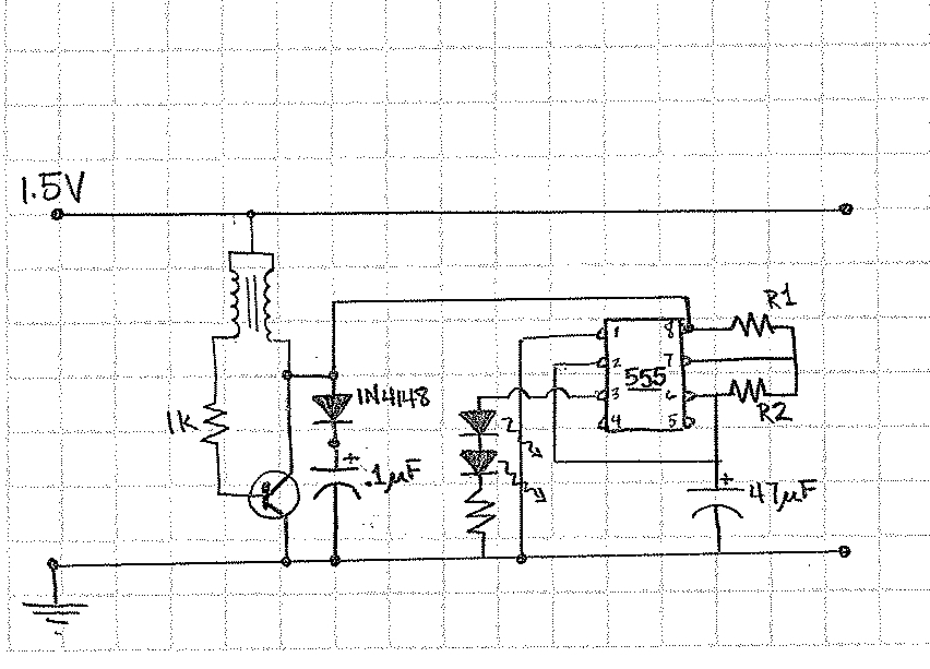

Adding a 1N4148 diode and a capacitor makes a peak detector. Then there will be DC across the capacitor. A 1N4001 diode is too slow.

Thanks guys. So, is this what you're saying I should do? I should wire my 555 in parallel with the capacitor on the joule thief? I made a sketch of how I understand it. Is it right?

Ive redrawn the diode.
I have no idea what voltage to expect across the capacitor.
Just connect the LED's with a small resistor in series across the 100nF.
Leave the 555 out of circuit for the test.
Measure the voltage on the cap.
If the voltage can drive the LED's, try a 1uF in place of the 100nF
I just checked it, and the voltage across the 100 nF cap is 3.3 volts. When I connect the LED's in parallel with the cap, it's not powerful enough to drive more than one of them. The single LED lights up nicely though. But when two are connected, they flash brightly for a second, then dim down to almost nothing so I can only see that they're on at all in the dark. When I connect the 555 timer, I get one flash, then nothing at all, not even a dim light, as far as I can see. I checked the voltage on the 555's capacitor, and it's oscillating between 2.1 and 2.2 volts. (I think for some reason, it's not discharging like it should).

I've had no problem running several of my flashing LED boards off a Joule Thief, with a 1N914 and 1 uf cap. Theses use low voltage AVR microcontrollers, even an RGB fader with separate LEDs.
