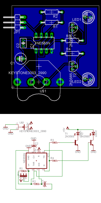

And maybe could someone look over the board and schematic attached to make sure it'll work? Basically, it's just a 555 timer circuit with two LEDs. Should it have a transistor to give the LEDs higher current? If not, does the circuit look ok?

I can't open those files :( - To share something please use some "universal" file type like .bmp or .gif (or even Word's .doc or Adobe's .pdf)

I don't see any connection to pins 4 (Reset - goes to pin 8 +V) and 2 (Trigger, should be connected to pin 6), but with only this file and not knowing if your board is single or double sided :confused: . If it is double sided, please disregard this.
It is a good practice to add a small capacitor from pin 5 to ground (will work without it, but it's better to put it)
The leds are in parallel and without a current limmiting resistor - again, this is not a good practice, but it works because of the coin cell's internal resistance. Just don't do it with a bigger cell or battery.

No, it's single-sided, what you see is what you get in that GIF. I was just following a simple 555 tutorial I had found on another site. Ok, let me redesign this and I'll repost both the schematic and board in GIF format. Thanks for the information!
Ok, it's updated. This should work, right? Thanks for the advice!
Hmmm, I just put this together on breadboard and it didn't work. If pin 1 wasn't grounded the LED (I only used one LED and left out the transistors for now) glowed dimly and quickly faded off. With pin 1 grounded properly, there was nothing. Any ideas?

Pin 4 should also be tied through your jumper to +5V (along with pin 8 and R1), instead of connecting directly.
Unless your LEDs have internal current limiting, with a 5V rating, you will need a current limiting resistor in series with each LED. Without them, you will take out the LEDs or the transistors or your battery, or perhaps all of them.
I would lay it out so that the plane is the -V (ground) node, not the positive battery node as you have it, just because that's conventionally the way it is done. It shouldn't matter in your case, unless you want to probe it with an oscilloscope. In that case, the plane is the most convenient place to connect your scope probe ground clip, and none of the voltages will make sense if you connected your scope ground to +V.
Yeah, I know GND is the convention, but in this case it was necessary to be +5V or there would be unrouted traces. Also, the +5V is a misnomer, it's +3V, but I always just use the 5V in Eagle since I know where to find it. And I don't think there's any easy way to attach pin 4 to the switch (my jumper is actually a switch)... hmmm, that could be a problem. Are there any problems that would make this not work, though? Because it isn't working on breadboard now...

I can't see the pcb layout but I see errors in the schematic.
Pin 2 and pin 6 must connect to the capacitor and pin 7 must connect between the two resistors.
I would fix your schematic but everything on it is upside down (Australia?).
