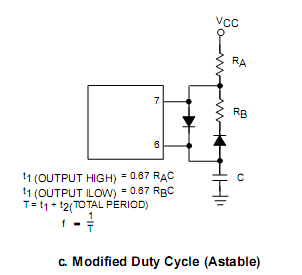

SO I was wondering, is it possible to adj. both the frequency and duty on a 555 timer? If so, will one affect the other? It was my understanding that when using a simple 555 for this idea, if I adj. the frequency, it would affect the duty?
Do you think I can accomplish my goal with this circuit?

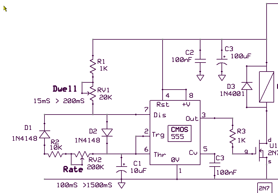

hi Phil,
This image is part of a circuit I use for the variable mark/space 555.
Vary the pots values and Ct to suit your freq/mark ranges.
EDIT: added the timing equations image.

The 555 can produce quite good square waves at TTL levels if required.
BTW: if you wanted to have the frequency control independent from the mark/space ratio control, use two 555's or a dual.
The 1st 555 as the astable with its output triggering the 2nd 555 as a monostable.
