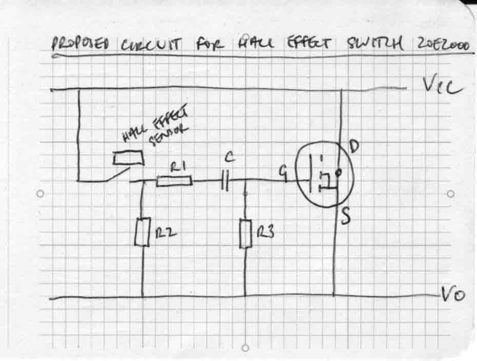

Consider some sort of position sensor to keep the timer synchronized with your sculpture. Perhaps a small magnet and hall effect sensor.
hi bruno,
Unless I am missing some point, why do you need an oscillator to generate the LED strobe pulse.
Position a magnet on the sculptures table and trigger a Hall effect device with the magnet as it rotates and use the output to strobe the LED's
By positioning the magnet at required point you will be able to get the LED flash to occur at any preset point in the statues rotation.
Hi Eric, if he just synchronized the timer to the sculpture with a magnet/hall effect sensor, he can control the "on" time of the LED. Alternatively, he could just use the timer in one-shot mode. Either way would be fine.
On the other hand, if he left it in multivibrator mode, he could switch between synchronized and free-running mode, for some even cooler effects. :)

Hi all. Thank you for the replies I think I may be getting somewhere. I think you are right I may have to drop the 555 timer and go with a hall effect sensor to generate the pulse.
The sculpture is a zoetrope which animates 3D figures on a disc. There are 18 different movements so I need 18 flashes per rotation.
If I put a hall effect sensor near the edge of the disc and had 18 magnets on the underside of the disc I would get 18 pulses per rotation, right? I could use this pulse to activate the gate on my MOSFET which would switch the LED's? I have attached an image of my proposed circuit. Could you let me know what you think and if you see any problems (or how many!)
Thank you and I'll send a photo of it when it's all working!

Hi, old thread but relevant to what I am doing. Also building a zoetrope, but I need 10 strobes per rotation, and for each strobe to be ~25ms regardless of the wheel speed. I am using a hall effect sensor tied in with a one-shot 555 timer circuit jut like the leftmost diagram in the attached image (using 1 uF for C and 27K for R), but the circuit is not functioning as planned: ie the hall effect sensor makes pin 3 go high (an LED) as long as the magnet is within range. So the 555 is not one-shotting, the circuit is running as though the LED is hooked directly to an LED.
I have the hall effect sensor hooked up red to (+), black to (-), and green/output to pin 2. I have a 10K resistor from pin two to (+). Without that 10K resistor, pin 3 and the LED goes high and *stays* high indefinitely.
Help will be greatly appreciated.
EB View attachment 65980
555
The 555 doesn't like the trigger to stay minus, so it might work ok when spinning. If it doesn't spinn fast enough try this: If you ac couple the input it will fire once then wait for the next negitive pulse.
Thanks for the reply! It was a goofy mistake anyways - by holding the magnet over the sensor, I was allowing the one-shot circuit to go high repeatedly, which happens so fast (durn electricity) I thought it was just not working. I was basically just holding the switch closed. That is a great suggestion though and I just might use that for something coming up
