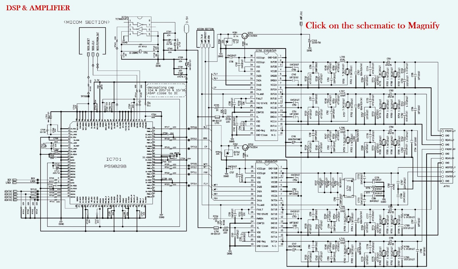

I need to feed my home theater system with 5.1 audio out from my computer. But no input ports in my Home Theater. I have feed Computer out to IC STA518 inputs (TP702/TP704/TP705/TP707/TP708/TP11/TP713). But sound out is very low. Please let me know how to boost or convert computer output signals to feed STA518 IC. Circuit Diagram attached.

Your sound level is low because you are feeding the outputs of IC701 that attenuates your new PWM signal. IC701 must be disconnected for you to feed your new signals to IC702 and IC703.
Is it possible to give analog stereo signal to STA518 input
EDIT: Its inputs are digital, not analog.
