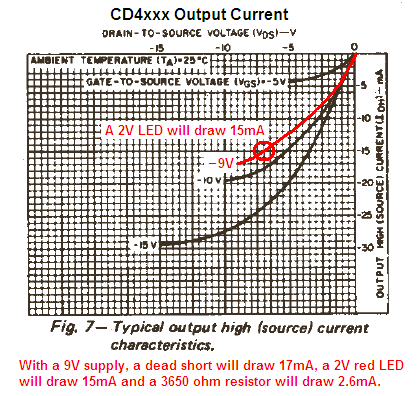

If you allow a voltage drop of only 0.5V at the output of a Cmos IC with a 10V supply then its minimum output current is only 1.3mA but is typically 2.6mA which is not much current.
But if you connect a 2V red LED directly to the output then the voltage drop of the output transistor is 7V and the typical current is 15mA (7.5mA minimum).
why you all have connected q output directly to +9v through 330 resistor? will not +9v battery push Iol(1.3ma) back current when q is low?
The 330 ohm resistors limit the current in the LEDs and are not needed.
When the output tries to conduct 15mA in an LED then the 330 ohm resistor will limit the current to about 10mA because then the 330 ohm resistor will have a voltage drop of 3.3V, the LED will have a voltage drop of 2V and the output transistor in the Cmos IC will have the remaining 5.7V voltage drop.
Look at the graphs of output current on Texas Instruments datasheets.
