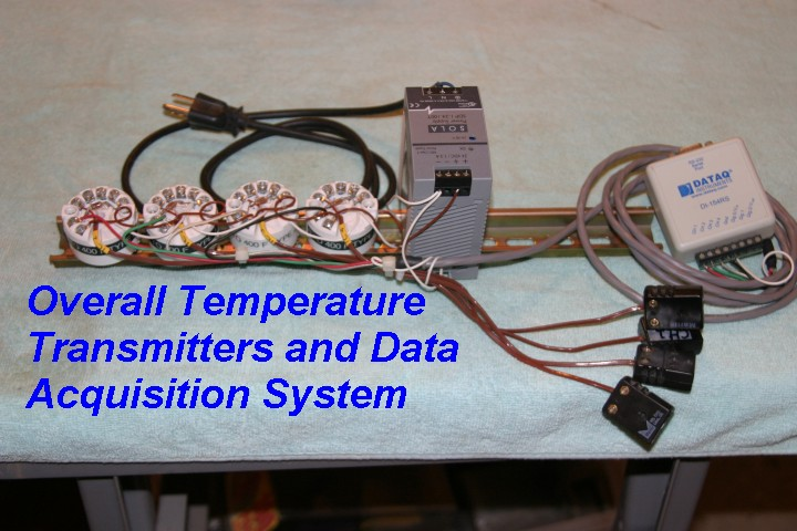

Yes, I use 24 volt switch mode power supplies all the time with sensors having a 4 to 20 mA output. You can use a SMPS or a Linear regulated DC power source. Here is an example of a SMPS (SOLA 24 VDC) power supply powering four each temperature sensors with each having a 4 to 20 mA output. Then as Gopher mentions each 4 to 20 mA loop is passed through a 250 Ohm 1% precision resistor providing 1 to 5 VDC which is passed to an ADC.
Ron
