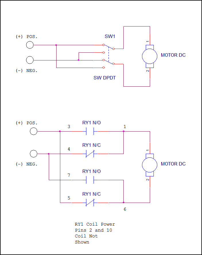

Rest assured, if wired exactly as drawn it will work. Not shown is the relay coil but I assume you have that covered. Deenergized the motor will run in one direction and with the relay energized the opposite direction.

Kwamie, originally you asked about using a relay to reverse a motor. That was all you asked so using the relay you have I gave you a circuit that would reverse a DC motor's direction. I pointed out that going from one direction and doing an immediate reverse was unwise. Now as to limit switches? What exactly, in detail, are you trying to do? Are you using a device like a linear actuator? Additionally, the drawing I posted was based on a "Ladder Logic" specifically for your relay including the pin numbers.

Kwame, attached is an image with two circuits. One uses a switch to reverse motor direction and the other is pretty much what I posted. Unless you have the relay mis-wired or something incorrectly wired the circuit will work. When the relay is energized the voltage polarity to the motor is reversed. On your relay:
Pins 1 (common) and 6 (common) should be tied to the motor power connections. Pins 3 N/O and 5 N/C are tied together and connected to one side of your power source. Pins 4 N/C and 7 N/O are tied together and connected to the other side of your power source. Just looking at either the switch or relay circuit should make it apparent that it works. Either circuit will reverse the polarity of the supply to the motor. The only way the relay circuit will not work is if there was a short that fused a pair of contacts. The drawings are self explanatory.
As to the motor. Yes, you can buy or build an H bridge to reverse polarity. The parts used would be a function of the current the motor draws under full load ratings since I assume the motor power will be fused.
Do you have a link to this motor or linear actuator?
Additionally, can you do as KISS suggest and just manually reverse polarity to the motor and have it reverse?
Ron
