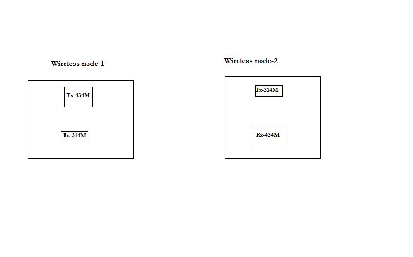

I am trying to communicate two wireless nodes having..
Node1. 434Mhz--Tx..315Mhz Rx..
Node2. 434Mhz--Rx..315Mhz Tx..
I have used ht640 and ht648 as encoder decoder for each wireless line(with different addressing)..
My problem is these two pairs does not work concurrently...they work perfectly when powered alone...but when both are powered together only 434Mhz pair works...I want to communicate to and for at same time...
Does these pairs interferes????

Any frequency of sufficient amplitude to enter a receiver’s front end will reduce system range and can even prevent reception entirely. Such may be the case when a transmitter at one frequency is located too close to a receiver of another frequency.
Really? Would explain a problem I had a while back...how do you avoid this problem?
One way is to share a single antenna and switch it between tx and rx, switching to tx when transmitting and to rx otherwise. That method precludes full duplex (simultaneous TX and RX) operation. Another way is to put additional bandpass (high Q) filtering at the receiver's front end. Another way is use as high gain and/or high Q (frequency selective) or cross-polarized antennas (one H pol, the other V pol).
No, sharing an antenna and switching tx and rx is half duplex. The method you just described is not simultaneous, the method the OP is describing is full duplex and is intended to be simultaneous, and requires two seperate and adequately spaced frequencies.
Using a notch filter would be another way to correct desensitization at the frequency that is causing problems.
Edit, I'm sorry, I misread your comment when you said "precludes". Dyslexia I suppose.
You are correct, it does "preclude" full duplex.
