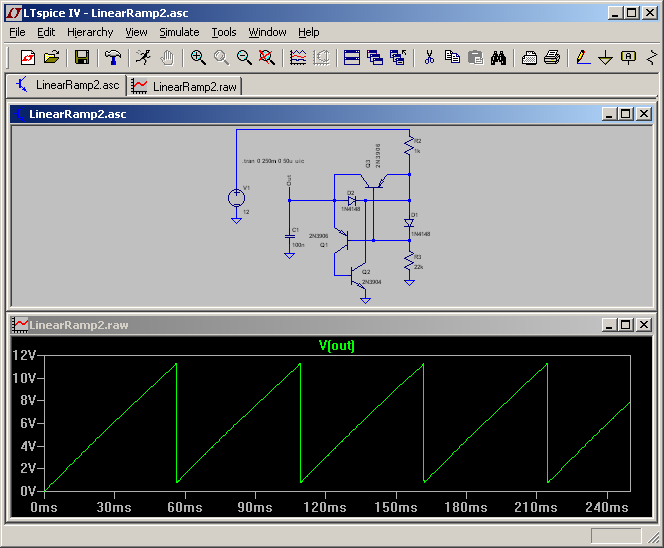

I have tested the following circuit:
With some changes (Changing R2 and the Capacitor C1) to the above circuit, I have achieved a 1 MHz Sawtooth signal, but a little crooked (not highly linear). The problem with this is that Transistor Q2 gets really HOT.

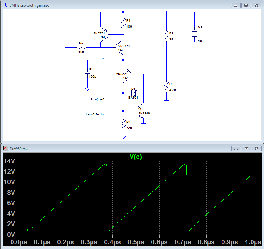

Here is a simulation of my version.

WOW! Hi Roff, thank you for your input. I see you are using a constant current source to charge the capacitor (how many mA is it?). Then, I see the fast discharge switch you created with 2N5771 and the BAT54 (Schottky Diode).

The current is about 4.1mA, The 2N5771 and 2N2369 are designed to be very high speed saturating switches, with low storage time (recovery from saturation). The BAT54 is a Baker clamp, keeping the 2N2369 out of saturation for even higher speed switching. I don't know if there is a through-hole version of it.
I am using LTspice. I included the file needed for simulation. If you want to run it, you might need a model for the BAT54. If you can't find one, I can post it here.

If you can't get a 2N5771 try a 2N3906. Sim shows it works nearly as well.
If you want to sim a jpfet used as a constant-current sorce in Roff's circuit to charge the cap C1, replace Q3 and Q4 with a single 2N5460 or similar, with its gate connected to the +V rail, source to R4, drain to C1. Make R4 330Ω. A BAT46WJ can substitute for a BAT54.

The JFET current source will almost certainly need to have a pot to set the current, because the transistor's parameters vary wildly from one part to the next. Of course, the BJT current source will probably also need a pot, also to compensate for component tolerances.
In your simulation, I noticed that the voltage on the base of the PNP never reaches full value, due to the RC time constant of the node. I don't think this is a good idea. One reason is that the peak voltage will be dependent on frequency. I would make the Thevenin resistance of R3 and R4 low enough to avoid this situation.
I also noticed that your current source is starting to saturate near the peak of the sawtooth. This accounts for the flattening as the ramp nears the peak.
The biggest problem is that, with the supply slowly ramping up from 0V to 15V (I used a 1ms ramp-up), your oscillator does not start. Lowering the resistance of r3-R4 will solve this problem.
