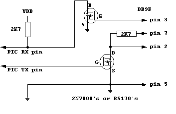

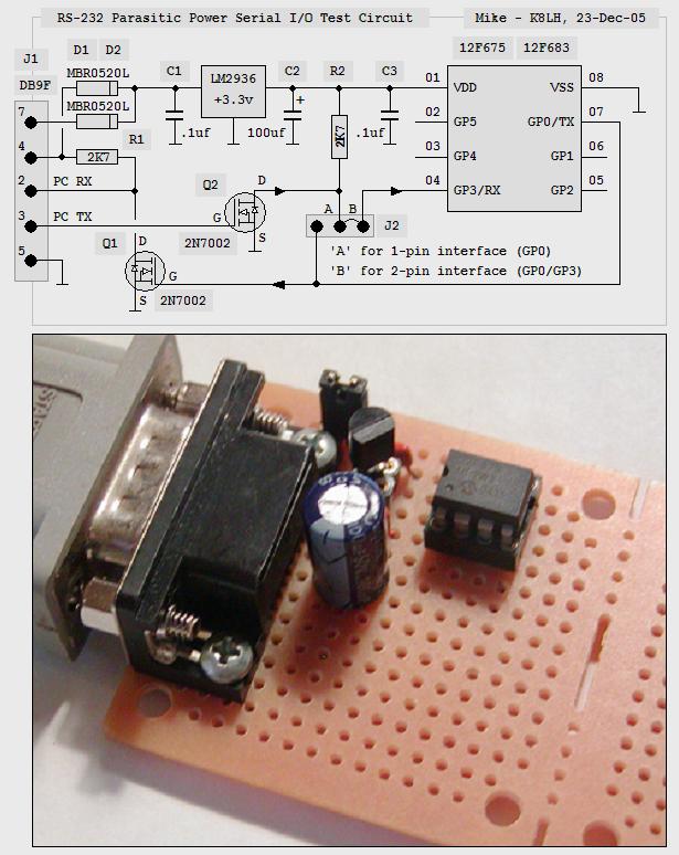

This might not be exactly what you're lookin' for but the open-drain outputs and pull-ups work great on anything (PC or laptop) I've connected to at data rates up to 115-kbaud... I've used VDD=5v and VDD=3.3v on the PIC side and the pull-up on the RS232 side can often be 5v on some laptops all the way up to 13v on some desktops...
Regards, Mike
