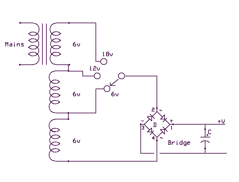

I still like the idea of using the multitap transformer to cut down the input voltage depending on what's selected. Is there any good way to do that? Or should I just be content with using heatsinks to dissipate heat?
If you used a centre tapped transformer, say 12Vac 0v 12Vac and a fullwave bridge, it would be possible to switch from the centre tap to one of the transformer ends.
That would give a ranges of 12Vac and 24Vac.
do you follow.?

The 15Vac from the transformer would be rectified and smoothed to about 20Vdc.
So the 'off load' voltage would be 20Vdc, at 1amp into a load at 1.5V the
20Vdc would drop to about 15Vdc, so you would have 15V-1.5V across the regulator..
So thats 13.5V * 1amp = 13.5Watts!!!!!

Mark,
Something like this dwg.
Hi Mark,
Your 100 ohm resistor from the output to the ADJ pin of the LM317 has a voltage across it of 1.25V. Then its current is 1.25V/100 ohms= 12.5mA. Its heat dissipation is only 1.25V x 12.5mA= 0.016W so a big 1W resistor is not needed.
Like all other IC regulators, the LM317 has thermal shutdown when it gets too hot. It turns off then turns on again when it has cooled a little.
Use a two-pole switch. One pole switches the transformer taps and the other pole switches the voltage-setting resistor.

So I'd need a switch with two poles, but about six throw? (That is assuming I have six selectable output voltages)
I had thought of that, but then I thought that it would need to handle up to 1.5A of current through the switch if it's switching the transformer. Is that right?
