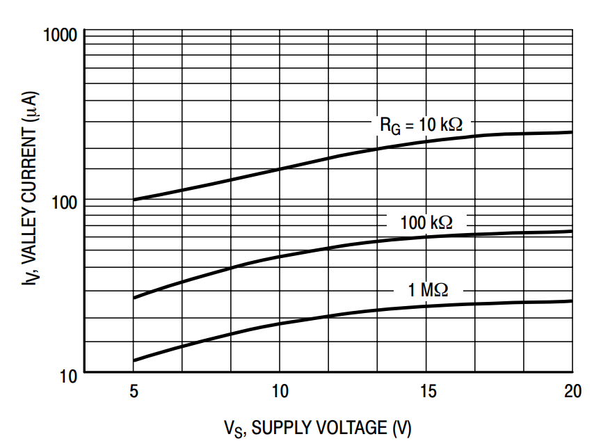

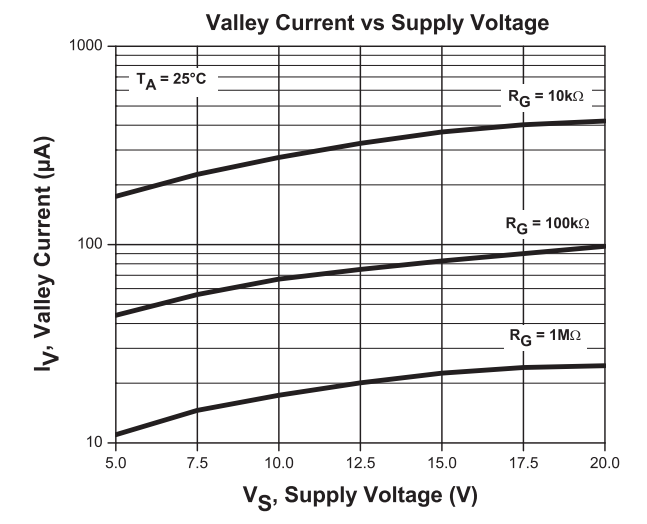

According to their datasheet's both Central and On Semi have different valley current vs supply voltage curves. Maybe you could add a resistor to compensate for that?
You are correct, its been many years since I have done work like this, I worked it out mathematically and it is working I just have to screw with the values on the rc to get the timinr correct again. Thanks.
