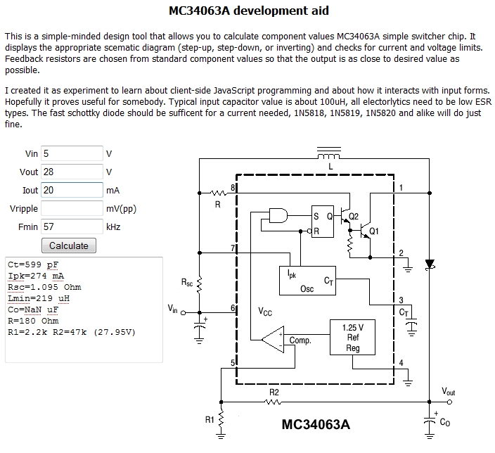

I need to make a BOOST STEP UP converter.
Requirements:
INPUT: 3.3v(MIN) to 5v(MAX)
OUTPUT: 27v-29v @ 20mA
Im not asking for anyone to do it for me i need some help in choosing how to accomplish this? Where do i start? What should i be looking for in a IC?
Any tips would be great full, THANKS!!!

Here's one way: **broken link removed**
I would double check your results from that tool against the data sheet just to be safe. It's a clever contribution but not a substitute for the data sheet and app notes. The tool has error checking for peak current, but not for duty cycle, voltage, or frequency.

the PSP has a LCD which is 28v @ 20mA which is what im using and it runs off 3.7v so im sure its doable...

Wade ... im taking a look now. I had that link before too!

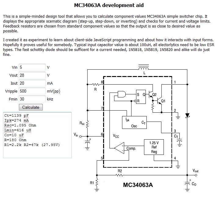

You need to put in a target ripple value to clear up the NaN (Not a Number, i.e. infinite) output capacitor. The input capacitor should 100 microfarads, not 100 microhenries.
Oops lol knew i didnt see something....
"The input capacitor should 100 microfarads, not 100 microhenries. "
Yeah i assumed a nice typo
well im going to order some of these chips to give it a try. Going to have to make some test calculations so i can order some Inductors also... unless i can make custom inductors... any links on thaT?
