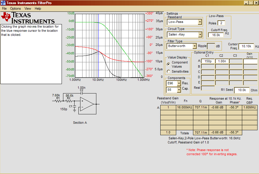

This is what TI filter pro shows.
E

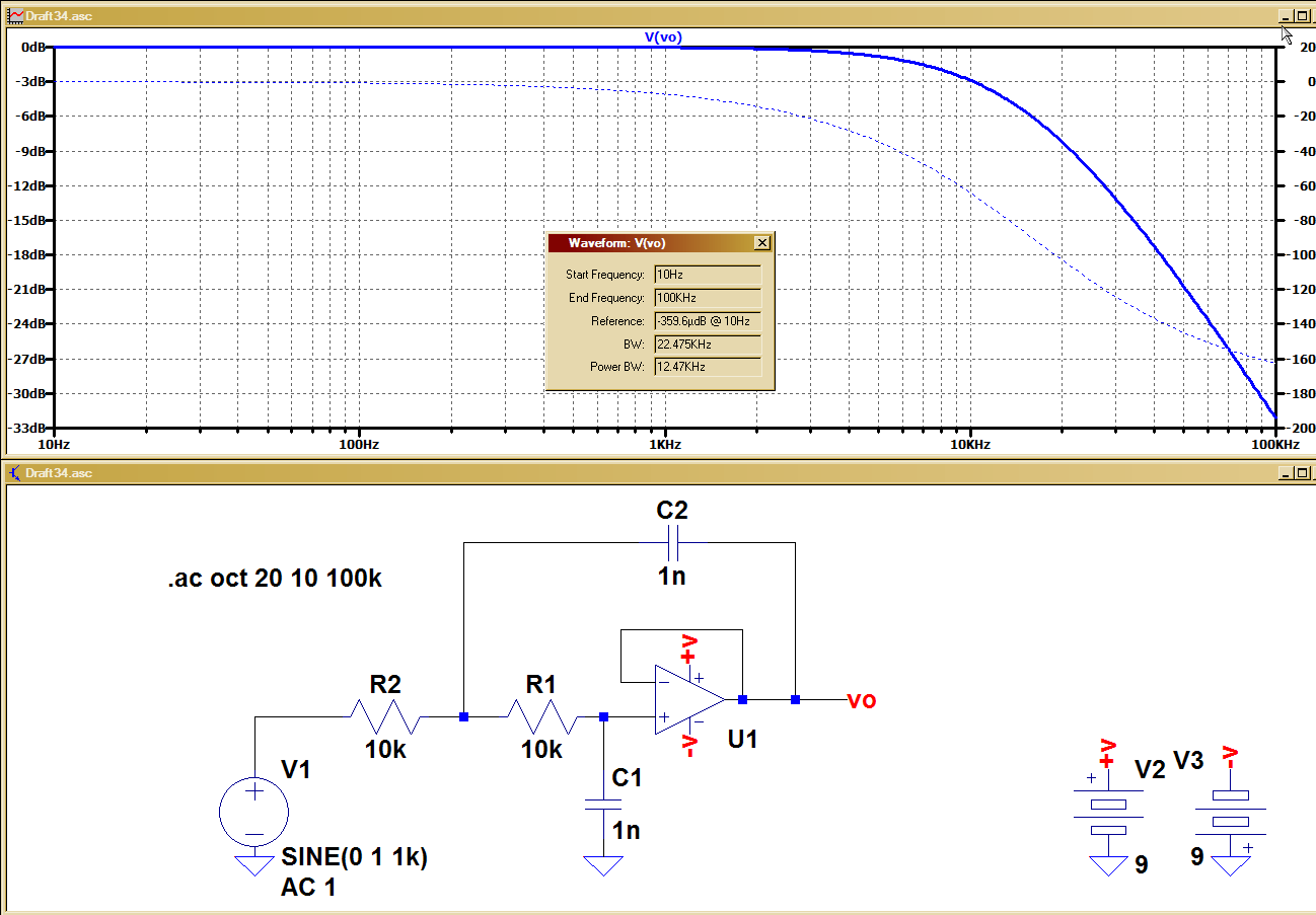

This what I see with LTSpice.
E
thanks for the reply. so what is this? i don't understand :confused:
Sorry, which bit is confusing.?

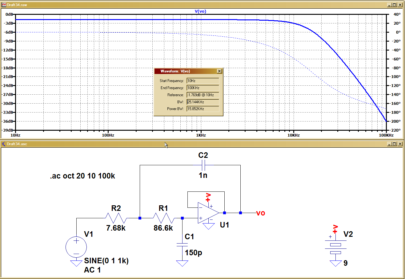

This image is using the TI component values
E
EDIT:
If you help with PBW and BW look at this link.

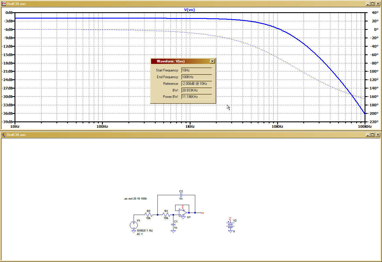

Odd. The post #6 pic is not what I see with LTspice (using the default opamp). Which opamp model did you use, Eric? Why is the ref voltage at -2dB?
Using a CA3140 OPA, the circuit has an overall attenuation of around 2dB.
Post your sims , I will compare.
E.

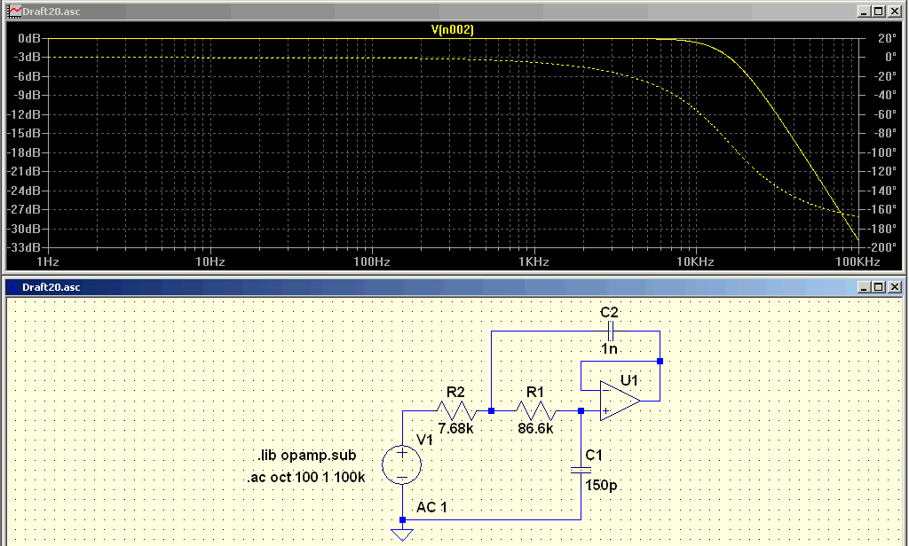

hi alec,
Woops! I used a single supply configuration!
E
Here's the result using the TI values:
