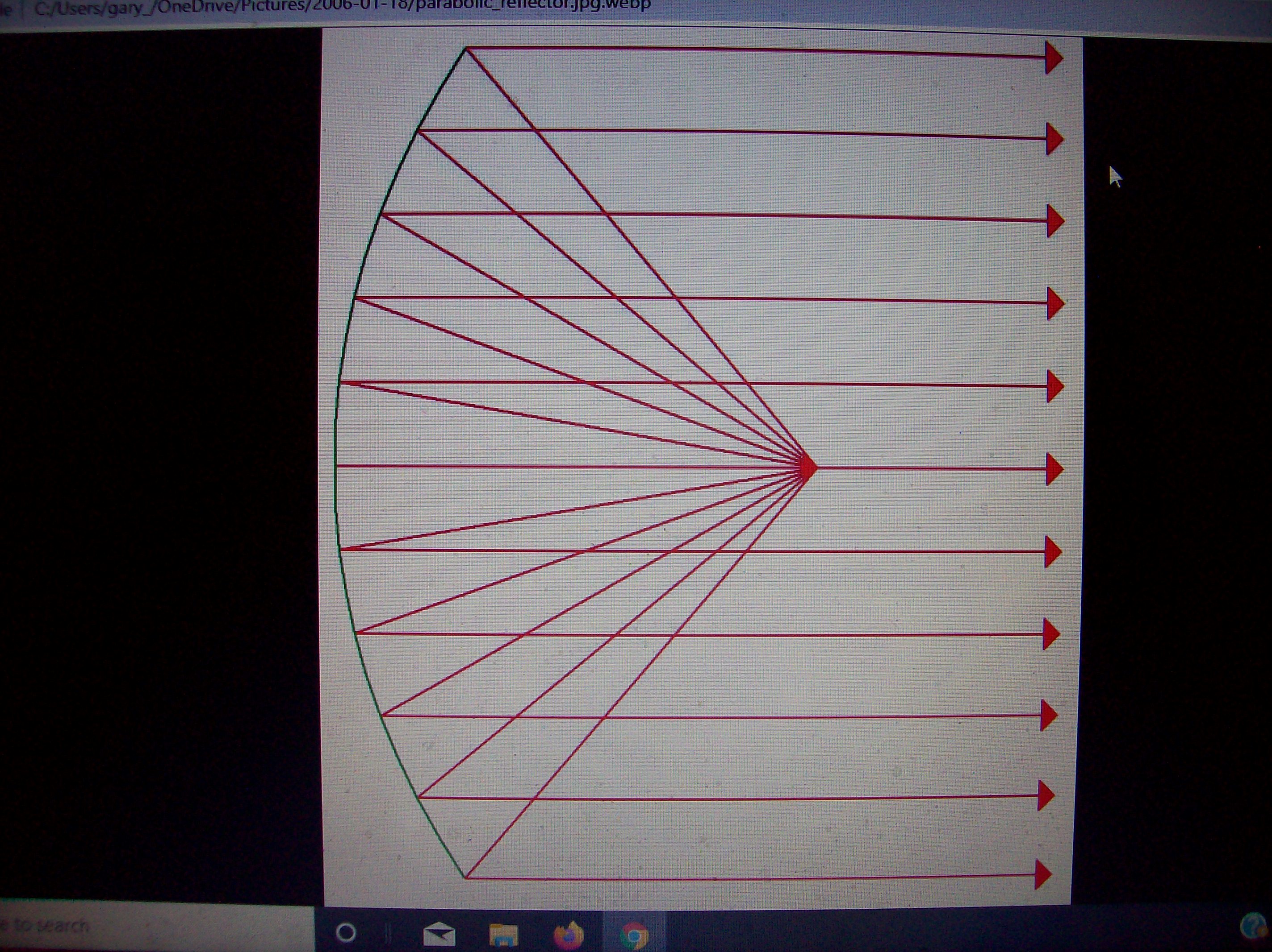

I am using a wooden dowel rod like a rifle barrel with reflector on each side of the barrel and gun sights down the barrel. I saved empty cereal box card board to cut out 20 pie shapes for the reflectors, I need to do geometry to calculate the shapes of each slice of pie. When this is finished it should work much better than the one I built long ago.

Ideally the reflectors should be paraboloidal.
And the hardest part is finding a parabola segmentl formula for a shape like this about 14" across with a 3" deep dish. Online calculator says 3" deep dish 14" diameter has a focal point of 16.34" but no math to calculate the parabola shape? This was high school geometry, I have been out of school too long to remember how to calculate a certain shape parabola.
The basic formula for a parabolic function is y= x^2.
